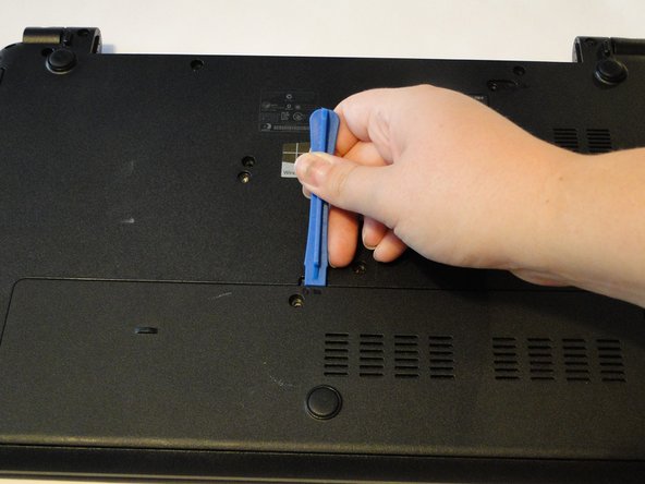

    • Using a Phillips 1 screwdriver, remove the 17 9 mm screws from the bottom of the laptop, including the one in the back panel.
    • Using a plastic opening tool, carefully remove the back panel.
    • Remove the 9mm screw under the back panel.
    • When reassembling, insert the back panel from the bottom edge first.

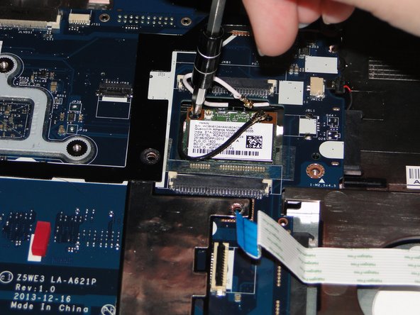

    • Using a Phillips 1 screwdriver, remove the two 5mm screws from the motherboard.
    • Using a Phillips 1 screwdriver, remove the black 5mm screw from the fan.
    • Using a Phillips 1 screwdriver, remove the black 3mm screw from the WiFi card.
