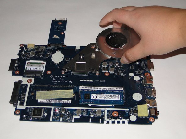

  10. Acer Aspire E1-510-2500 Fan Replacement, Fan: crwdns2935265:010crwdnd2935265:01crwdnd2935265:01crwdne2935265:0
    • Detach the connector between the fan and the motherboard.
  11. Acer Aspire E1-510-2500 Fan Replacement: crwdns2935265:011crwdnd2935265:01crwdnd2935265:03crwdne2935265:0 Acer Aspire E1-510-2500 Fan Replacement: crwdns2935265:011crwdnd2935265:02crwdnd2935265:03crwdne2935265:0 Acer Aspire E1-510-2500 Fan Replacement: crwdns2935265:011crwdnd2935265:03crwdnd2935265:03crwdne2935265:0
    • Flip the motherboard over so that the back is face-up.
    • Unscrew the three 5mm screws and lift the fan off of the motherboard.
