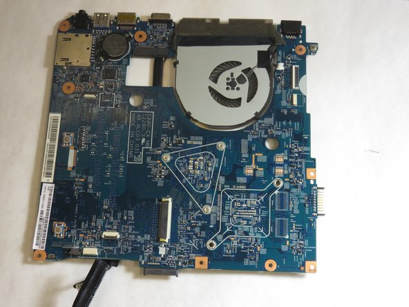

  11. Acer Aspire E1-470P-6659 Motherboard Replacement, Motherboard: crwdns2935265:011crwdnd2935265:01crwdnd2935265:03crwdne2935265:0 Acer Aspire E1-470P-6659 Motherboard Replacement, Motherboard: crwdns2935265:011crwdnd2935265:02crwdnd2935265:03crwdne2935265:0 Acer Aspire E1-470P-6659 Motherboard Replacement, Motherboard: crwdns2935265:011crwdnd2935265:03crwdnd2935265:03crwdne2935265:0
    • Remove additional screws that can be found on the motherboard.
    • Remove the green wifi card from motherboard.
    • Use spudger to disconnect the fan and motherboard from laptop.
  12. Acer Aspire E1-470P-6659 Motherboard Replacement: crwdns2935265:012crwdnd2935265:01crwdnd2935265:02crwdne2935265:0 Acer Aspire E1-470P-6659 Motherboard Replacement: crwdns2935265:012crwdnd2935265:02crwdnd2935265:02crwdne2935265:0
    • Remove the cable attached to motherboard.
    • Gently lift and remove the motherboard from the laptop.
