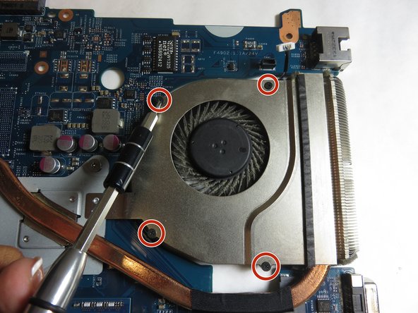

  13. Acer Aspire E1-470P-6659 Cooling Fan Replacement, Cooling Fan: crwdns2935265:013crwdnd2935265:01crwdnd2935265:02crwdne2935265:0 Acer Aspire E1-470P-6659 Cooling Fan Replacement, Cooling Fan: crwdns2935265:013crwdnd2935265:02crwdnd2935265:02crwdne2935265:0
    • Flip the motherboard and fan piece over.
    • Remove the four screws using the Phillips #000 Screwdriver.

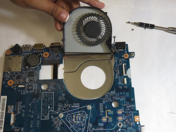

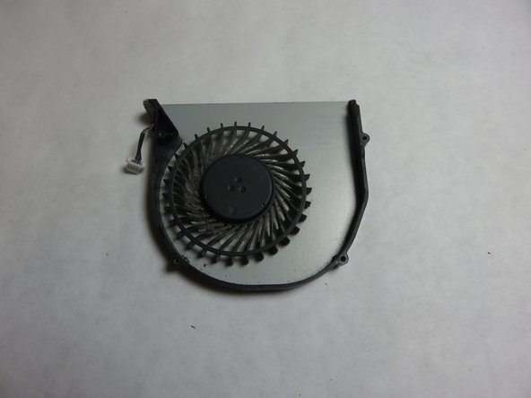

  14. Acer Aspire E1-470P-6659 Cooling Fan Replacement: crwdns2935265:014crwdnd2935265:01crwdnd2935265:03crwdne2935265:0 Acer Aspire E1-470P-6659 Cooling Fan Replacement: crwdns2935265:014crwdnd2935265:02crwdnd2935265:03crwdne2935265:0 Acer Aspire E1-470P-6659 Cooling Fan Replacement: crwdns2935265:014crwdnd2935265:03crwdnd2935265:03crwdne2935265:0
    • Flip the motherboard over and slowly remove the tape holding the cooling fan down.
    • Use a spudger to remove the top of the fan from the base of the fan.
    • Remove the cooling fan component from both the tape and the motherboard.
