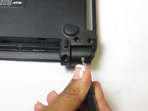

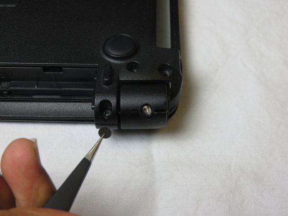

    • Locate the screws connected to the hinge of the laptop. Small, black stickers hide them from immediate view.
  6. Acer Aspire E1-470P-6659  LCD Panel & Faceplate Replacement: crwdns2935265:06crwdnd2935265:01crwdnd2935265:03crwdne2935265:0 Acer Aspire E1-470P-6659  LCD Panel & Faceplate Replacement: crwdns2935265:06crwdnd2935265:02crwdnd2935265:03crwdne2935265:0 Acer Aspire E1-470P-6659  LCD Panel & Faceplate Replacement: crwdns2935265:06crwdnd2935265:03crwdnd2935265:03crwdne2935265:0
    • On both corners, use tweezers to remove small plastic sticker hiding the screws.
    • Remove screws using Phillips #0 screwdriver.

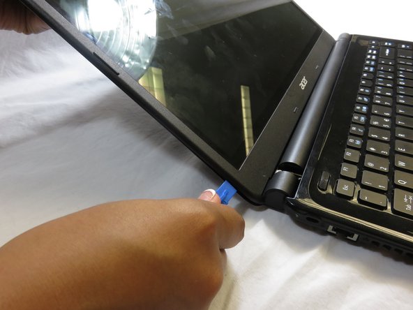

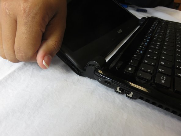

    • Turn the laptop over and open it up.
    • Using a prying tool, run along all edges of the display to pry the front face plate from the cover.
    • Use your fingers to pull the LCD panel and faceplate from the backing.

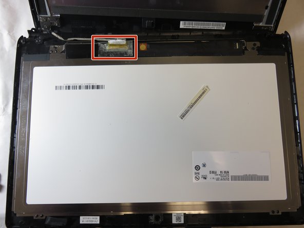

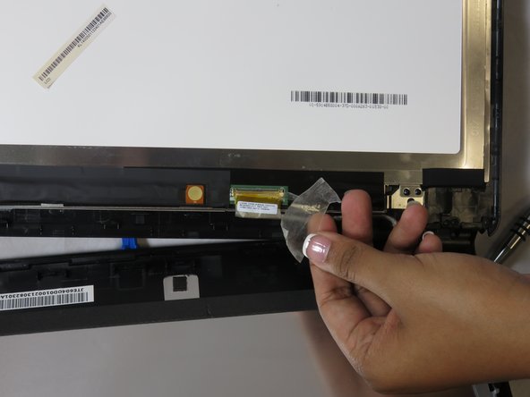

  8. Acer Aspire E1-470P-6659  LCD Panel & Faceplate Replacement: crwdns2935265:08crwdnd2935265:01crwdnd2935265:03crwdne2935265:0 Acer Aspire E1-470P-6659  LCD Panel & Faceplate Replacement: crwdns2935265:08crwdnd2935265:02crwdnd2935265:03crwdne2935265:0 Acer Aspire E1-470P-6659  LCD Panel & Faceplate Replacement: crwdns2935265:08crwdnd2935265:03crwdnd2935265:03crwdne2935265:0
    • LCD with faceplate should separate, be careful not to pull completely away because there is a cable still attached to the display.
    • Carefully peel tape away from cable lead and separate cable from LCD panel.
  9. Acer Aspire E1-470P-6659  LCD Panel & Faceplate Replacement: crwdns2935265:09crwdnd2935265:01crwdnd2935265:01crwdne2935265:0
    • Remove the LCD Panel and faceplate from the device.
