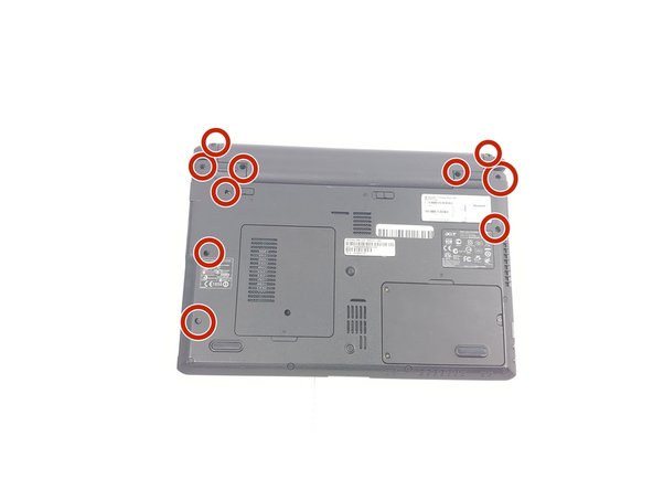

    • Using the Phillips #1 screwdriver, unscrew the ten screws securing the back panel.

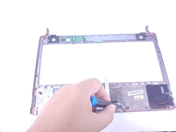

    • Remove the grey keyboard cover with a spudger.
  6. Acer Aspire AS3810TZ-4806 Trackpad Replacement: crwdns2935265:06crwdnd2935265:01crwdnd2935265:02crwdne2935265:0 Acer Aspire AS3810TZ-4806 Trackpad Replacement: crwdns2935265:06crwdnd2935265:02crwdnd2935265:02crwdne2935265:0
    • Unscrew the trackpad sensor from the keyboard cover and remove the sensor.
