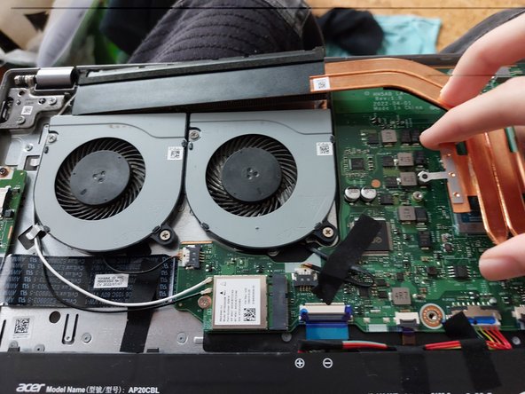

  3. Acer Aspire A515-47 Thermal Paste Replacment, Taking the Heatsink Out: crwdns2935265:03crwdnd2935265:01crwdnd2935265:03crwdne2935265:0 Acer Aspire A515-47 Thermal Paste Replacment, Taking the Heatsink Out: crwdns2935265:03crwdnd2935265:02crwdnd2935265:03crwdne2935265:0 Acer Aspire A515-47 Thermal Paste Replacment, Taking the Heatsink Out: crwdns2935265:03crwdnd2935265:03crwdnd2935265:03crwdne2935265:0

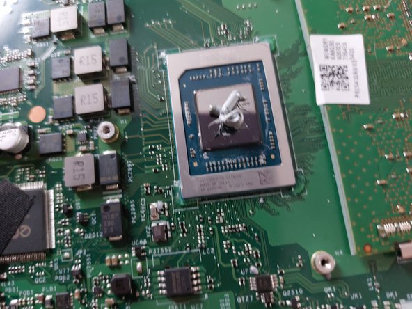

    • Nice.Now all you have to do is to take the heatsink out.Just take it from the top (See picture 1),lift it up a bit and then take it out.You can see this in the pictures
  4. Acer Aspire A515-47 Thermal Paste Replacment, Cleaning up the previous Thermal Paste: crwdns2935265:04crwdnd2935265:01crwdnd2935265:03crwdne2935265:0 Acer Aspire A515-47 Thermal Paste Replacment, Cleaning up the previous Thermal Paste: crwdns2935265:04crwdnd2935265:02crwdnd2935265:03crwdne2935265:0 Acer Aspire A515-47 Thermal Paste Replacment, Cleaning up the previous Thermal Paste: crwdns2935265:04crwdnd2935265:03crwdnd2935265:03crwdne2935265:0

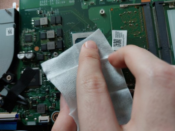

    • Good Job.You are halfway there.Now,take a wet wipe and wipe the thermal paste off the CPU
    • If there is Thermal Paste around the CPU,take a toothpick and scrape off the Thermal Paste.Be careful to not destroy a fuse
    • Dont take a napkin or a cloth and wet it with water.Otherwise,your laptop will be waterlocked (Defective maybe beyond repair).Use a wet wipe like I use in picture 2

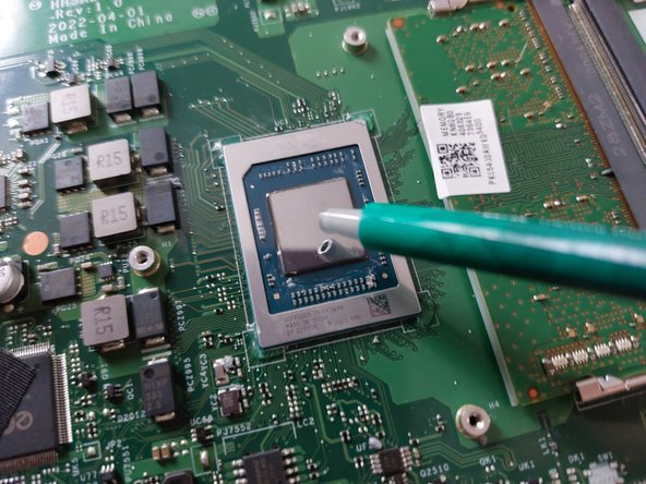

    • Well,after you cleaned off the Thermal Paste,its time to apply it.If the Thermal Paste has a plug,just remove it
    • Now,put the tip of your Thermal Paste on your CPU,or put it just above the CPU.
    • Here,you have 2 options.You can put a dot,or you can make an x (like how i tried to make it).The way you put it does not affect anything,just as long as its on the CPU

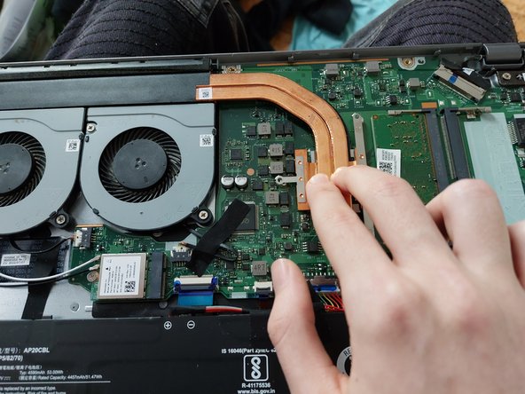

  6. Acer Aspire A515-47 Thermal Paste Replacment, Putting back the HeatSink: crwdns2935265:06crwdnd2935265:01crwdnd2935265:03crwdne2935265:0 Acer Aspire A515-47 Thermal Paste Replacment, Putting back the HeatSink: crwdns2935265:06crwdnd2935265:02crwdnd2935265:03crwdne2935265:0 Acer Aspire A515-47 Thermal Paste Replacment, Putting back the HeatSink: crwdns2935265:06crwdnd2935265:03crwdnd2935265:03crwdne2935265:0
    • Congrats,you applied the new Thermal Paste.Now,to make this guide short,its just what we did,but in reverse.But here is the detailed assembly
    • First,put the grid part of the heatsink in its designated place
    • Now,make sure the part of the heatsink that goes over the CPU is over the CPU and the Screw Places are aligned with the holes where the screws are placed

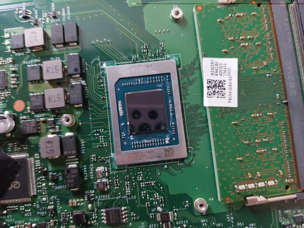

    • Make sure to apply a bit of pressure over the CPU so that the Thermal Paste can spread over the CPU (Like picture 3)
    • Now that you have done that,put the heatsink screws back in their place and tight them up so that the Heatsink wont get loose and create problems
