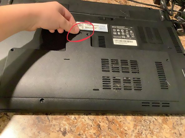

  1. Acer Aspire 7741G-6426 Hard Drive Replacement, Take off the cover: crwdns2935265:01crwdnd2935265:01crwdnd2935265:02crwdne2935265:0 Acer Aspire 7741G-6426 Hard Drive Replacement, Take off the cover: crwdns2935265:01crwdnd2935265:02crwdnd2935265:02crwdne2935265:0
    • Use your fingernail to pry of the cover
    • Take out the 4 Phillips head Screws
    • Take out the Phillips head screws
    • Slide out tray and pull tab
    • Lift up and then pull hard drive out
