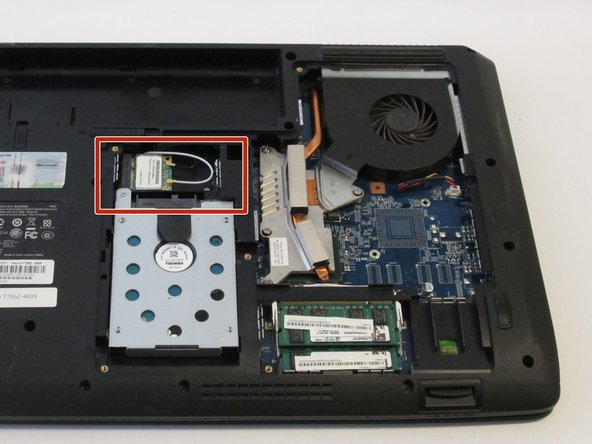

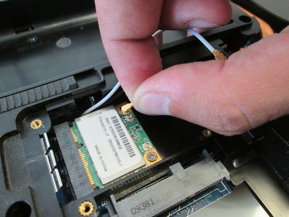

  6. Acer Aspire 7736Z-4809 LCD Module Replacement, Wireless Module: crwdns2935265:06crwdnd2935265:01crwdnd2935265:03crwdne2935265:0 Acer Aspire 7736Z-4809 LCD Module Replacement, Wireless Module: crwdns2935265:06crwdnd2935265:02crwdnd2935265:03crwdne2935265:0 Acer Aspire 7736Z-4809 LCD Module Replacement, Wireless Module: crwdns2935265:06crwdnd2935265:03crwdnd2935265:03crwdne2935265:0
    • Remove the white antenna of the wireless module.
    • Use tweezers if you do not prefer using hands.
  7. Acer Aspire 7736Z-4809 LCD Module Replacement: crwdns2935265:07crwdnd2935265:01crwdnd2935265:02crwdne2935265:0 Acer Aspire 7736Z-4809 LCD Module Replacement: crwdns2935265:07crwdnd2935265:02crwdnd2935265:02crwdne2935265:0
    • Remove the black antenna of the wireless module.

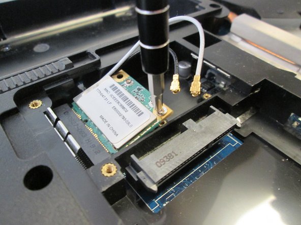

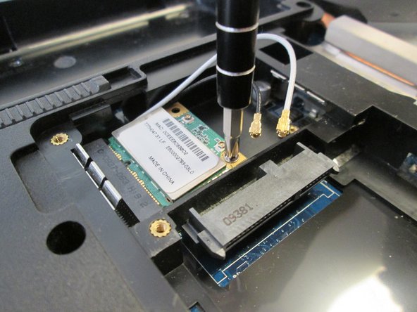

  8. Acer Aspire 7736Z-4809 LCD Module Replacement: crwdns2935265:08crwdnd2935265:01crwdnd2935265:03crwdne2935265:0 Acer Aspire 7736Z-4809 LCD Module Replacement: crwdns2935265:08crwdnd2935265:02crwdnd2935265:03crwdne2935265:0 Acer Aspire 7736Z-4809 LCD Module Replacement: crwdns2935265:08crwdnd2935265:03crwdnd2935265:03crwdne2935265:0
    • Use the Phillips #1 screwdriver to remove the two 4.8mm Phillips #1 screws.

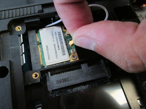

  9. Acer Aspire 7736Z-4809 LCD Module Replacement: crwdns2935265:09crwdnd2935265:01crwdnd2935265:02crwdne2935265:0 Acer Aspire 7736Z-4809 LCD Module Replacement: crwdns2935265:09crwdnd2935265:02crwdnd2935265:02crwdne2935265:0
    • Remove the wireless module from the laptop.

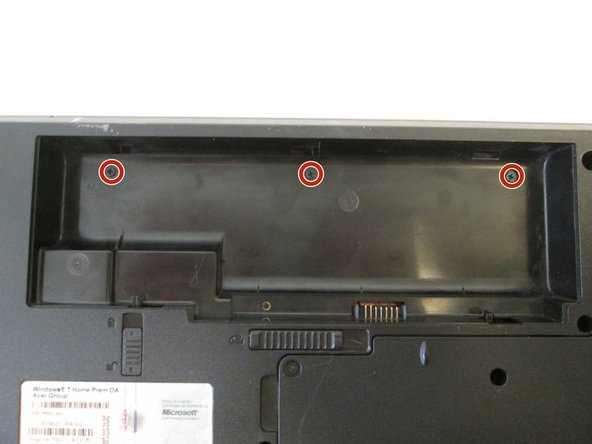

  10. Acer Aspire 7736Z-4809 LCD Module Replacement, LCD  Module: crwdns2935265:010crwdnd2935265:01crwdnd2935265:01crwdne2935265:0
    • Use the Phillips #1 screwdriver to remove the two 6.5mm Phillips #1 screws.

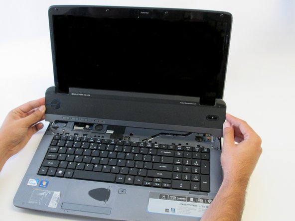

  12. Acer Aspire 7736Z-4809 LCD Module Replacement: crwdns2935265:012crwdnd2935265:01crwdnd2935265:03crwdne2935265:0 Acer Aspire 7736Z-4809 LCD Module Replacement: crwdns2935265:012crwdnd2935265:02crwdnd2935265:03crwdne2935265:0 Acer Aspire 7736Z-4809 LCD Module Replacement: crwdns2935265:012crwdnd2935265:03crwdnd2935265:03crwdne2935265:0
    • Orient the laptop so that the hinges between the LCD module and the laptop's bottom base are visible.
    • Use the plastic opening tools to separate the speaker panel from the laptop.
  13. Acer Aspire 7736Z-4809 LCD Module Replacement: crwdns2935265:013crwdnd2935265:01crwdnd2935265:02crwdne2935265:0 Acer Aspire 7736Z-4809 LCD Module Replacement: crwdns2935265:013crwdnd2935265:02crwdnd2935265:02crwdne2935265:0
    • Flip over the LCD module of the laptop.
    • Insert the opening tool into the crack between the panel and the frame at either end. Slide the opening tool across the line. Reinsert the opening tool into the crack and apply leverage until the frame releases.
    • Repeat this step with the other side of the laptop.
  14. Acer Aspire 7736Z-4809 LCD Module Replacement: crwdns2935265:014crwdnd2935265:01crwdnd2935265:03crwdne2935265:0 Acer Aspire 7736Z-4809 LCD Module Replacement: crwdns2935265:014crwdnd2935265:02crwdnd2935265:03crwdne2935265:0 Acer Aspire 7736Z-4809 LCD Module Replacement: crwdns2935265:014crwdnd2935265:03crwdnd2935265:03crwdne2935265:0
    • Gently hold the speaker panel by the sides and pull upwards to release the panel.

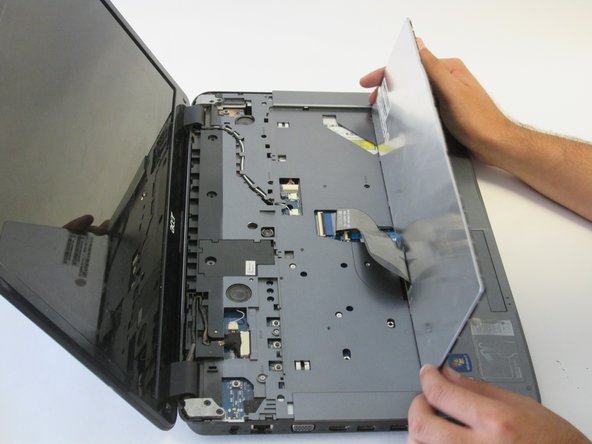

    • Insert a finger into the opening above the F11 key and pry the keyboard until it is released from the casing.
  17. Acer Aspire 7736Z-4809 LCD Module Replacement: crwdns2935265:017crwdnd2935265:01crwdnd2935265:03crwdne2935265:0 Acer Aspire 7736Z-4809 LCD Module Replacement: crwdns2935265:017crwdnd2935265:02crwdnd2935265:03crwdne2935265:0 Acer Aspire 7736Z-4809 LCD Module Replacement: crwdns2935265:017crwdnd2935265:03crwdnd2935265:03crwdne2935265:0
    • Gently raise the keyboard with your hands.
  18. Acer Aspire 7736Z-4809 LCD Module Replacement: crwdns2935265:018crwdnd2935265:01crwdnd2935265:03crwdne2935265:0 Acer Aspire 7736Z-4809 LCD Module Replacement: crwdns2935265:018crwdnd2935265:02crwdnd2935265:03crwdne2935265:0 Acer Aspire 7736Z-4809 LCD Module Replacement: crwdns2935265:018crwdnd2935265:03crwdnd2935265:03crwdne2935265:0

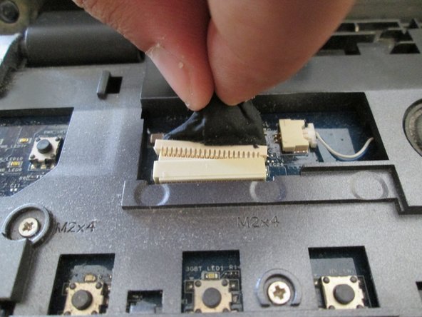

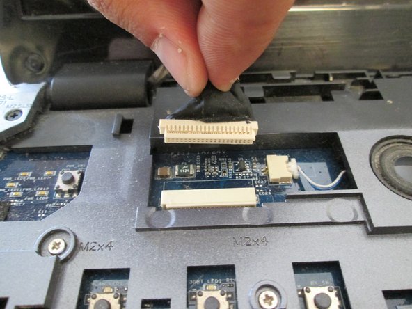

    • Lift the black latch upwards to release the ZIF connector.
  19. Acer Aspire 7736Z-4809 LCD Module Replacement: crwdns2935265:019crwdnd2935265:01crwdnd2935265:01crwdne2935265:0
    • Remove the keyboard from the keyboard slot.

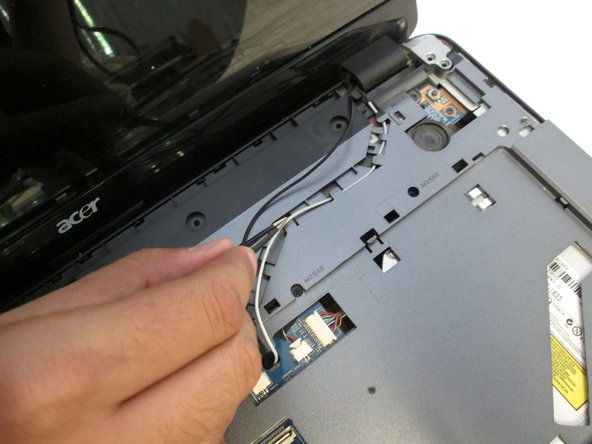

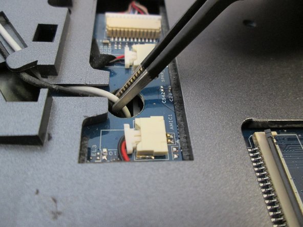

  20. Acer Aspire 7736Z-4809 LCD Module Replacement, LCD Module: crwdns2935265:020crwdnd2935265:01crwdnd2935265:03crwdne2935265:0 Acer Aspire 7736Z-4809 LCD Module Replacement, LCD Module: crwdns2935265:020crwdnd2935265:02crwdnd2935265:03crwdne2935265:0 Acer Aspire 7736Z-4809 LCD Module Replacement, LCD Module: crwdns2935265:020crwdnd2935265:03crwdnd2935265:03crwdne2935265:0

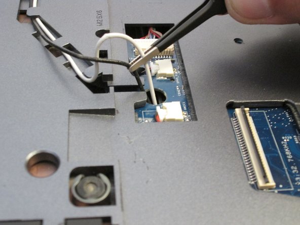

    • Use tweezers to pull the black and white antennas out of the hole.
    • Handle this step with care.
    • These are the same antennas of the wireless module.

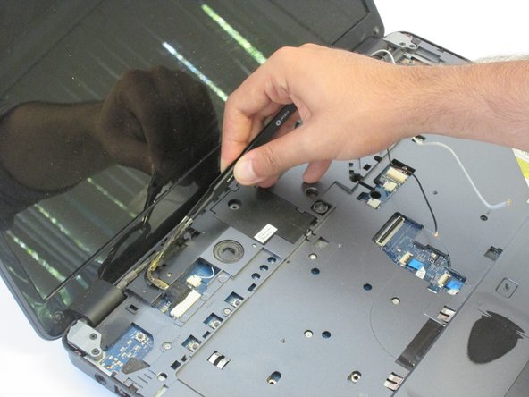

  21. Acer Aspire 7736Z-4809 LCD Module Replacement: crwdns2935265:021crwdnd2935265:01crwdnd2935265:03crwdne2935265:0 Acer Aspire 7736Z-4809 LCD Module Replacement: crwdns2935265:021crwdnd2935265:02crwdnd2935265:03crwdne2935265:0 Acer Aspire 7736Z-4809 LCD Module Replacement: crwdns2935265:021crwdnd2935265:03crwdnd2935265:03crwdne2935265:0
    • Remove the antennas from underneath the tabs that hold them in place.
    • Do this until they are no longer underneath any tabs.
    • Be careful when handling with the antennas since they are sensitive.

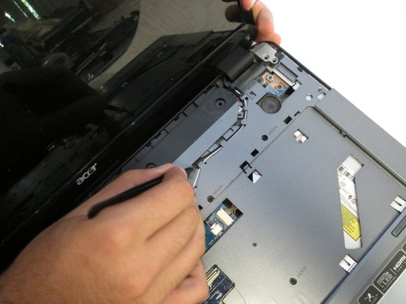

  22. Acer Aspire 7736Z-4809 LCD Module Replacement: crwdns2935265:022crwdnd2935265:01crwdnd2935265:03crwdne2935265:0 Acer Aspire 7736Z-4809 LCD Module Replacement: crwdns2935265:022crwdnd2935265:02crwdnd2935265:03crwdne2935265:0 Acer Aspire 7736Z-4809 LCD Module Replacement: crwdns2935265:022crwdnd2935265:03crwdnd2935265:03crwdne2935265:0

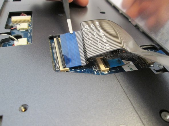

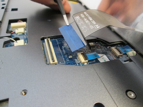

    • Use tweezers to push the cable out of the port.
    • The cable is located on the left side of the open laptop.
    • Be careful when handling the cable.

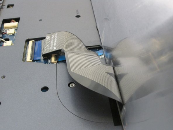

  23. Acer Aspire 7736Z-4809 LCD Module Replacement: crwdns2935265:023crwdnd2935265:01crwdnd2935265:02crwdne2935265:0 Acer Aspire 7736Z-4809 LCD Module Replacement: crwdns2935265:023crwdnd2935265:02crwdnd2935265:02crwdne2935265:0
    • Release the cable from the tabs holding it in place.

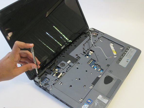

  24. Acer Aspire 7736Z-4809 LCD Module Replacement: crwdns2935265:024crwdnd2935265:01crwdnd2935265:02crwdne2935265:0 Acer Aspire 7736Z-4809 LCD Module Replacement: crwdns2935265:024crwdnd2935265:02crwdnd2935265:02crwdne2935265:0

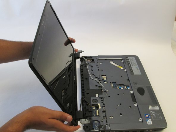

    • Use the Phillips #1 screwdriver to remove the four 11mm Phillips #1 screws.
  25. Acer Aspire 7736Z-4809 LCD Module Replacement: crwdns2935265:025crwdnd2935265:01crwdnd2935265:02crwdne2935265:0 Acer Aspire 7736Z-4809 LCD Module Replacement: crwdns2935265:025crwdnd2935265:02crwdnd2935265:02crwdne2935265:0
    • Grab the display assembly from the base and lift it up and off the base.
