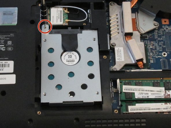

  6. Acer Aspire 7736Z-4809 Hard Drive Replacement, Hard Drive: crwdns2935265:06crwdnd2935265:01crwdnd2935265:02crwdne2935265:0 Acer Aspire 7736Z-4809 Hard Drive Replacement, Hard Drive: crwdns2935265:06crwdnd2935265:02crwdnd2935265:02crwdne2935265:0
    • Use the Phillips #1 screwdriver to remove the 3.5mm Phillips #1 screw.
  7. Acer Aspire 7736Z-4809 Hard Drive Replacement: crwdns2935265:07crwdnd2935265:01crwdnd2935265:02crwdne2935265:0 Acer Aspire 7736Z-4809 Hard Drive Replacement: crwdns2935265:07crwdnd2935265:02crwdnd2935265:02crwdne2935265:0
    • Slide the bracket towards you to release it from the frame.
  8. Acer Aspire 7736Z-4809 Hard Drive Replacement: crwdns2935265:08crwdnd2935265:01crwdnd2935265:03crwdne2935265:0 Acer Aspire 7736Z-4809 Hard Drive Replacement: crwdns2935265:08crwdnd2935265:02crwdnd2935265:03crwdne2935265:0 Acer Aspire 7736Z-4809 Hard Drive Replacement: crwdns2935265:08crwdnd2935265:03crwdnd2935265:03crwdne2935265:0
    • Use the black tab to pull the hard drive up and out of the laptop.

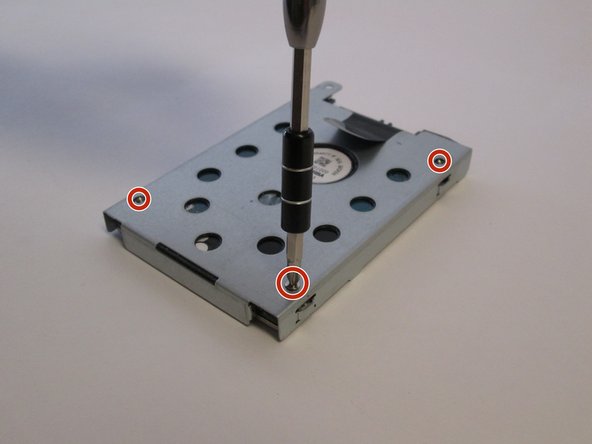

  9. Acer Aspire 7736Z-4809 Hard Drive Replacement: crwdns2935265:09crwdnd2935265:01crwdnd2935265:02crwdne2935265:0 Acer Aspire 7736Z-4809 Hard Drive Replacement: crwdns2935265:09crwdnd2935265:02crwdnd2935265:02crwdne2935265:0
    • Use the Phillips #1 screwdriver to remove the four 3.5 Phillips #1 screws.
  10. Acer Aspire 7736Z-4809 Hard Drive Replacement: crwdns2935265:010crwdnd2935265:01crwdnd2935265:01crwdne2935265:0
    • Remove the hard drive from the bracket and install the new hard drive.
