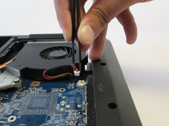

  6. Acer Aspire 7736Z-4809 CPU Fan Replacement, CPU Fan: crwdns2935265:06crwdnd2935265:01crwdnd2935265:03crwdne2935265:0 Acer Aspire 7736Z-4809 CPU Fan Replacement, CPU Fan: crwdns2935265:06crwdnd2935265:02crwdnd2935265:03crwdne2935265:0 Acer Aspire 7736Z-4809 CPU Fan Replacement, CPU Fan: crwdns2935265:06crwdnd2935265:03crwdnd2935265:03crwdne2935265:0
    • Use tweezers to remove the fan cable from its slot.
    • The cables consist of red, black, and yellow wires.
