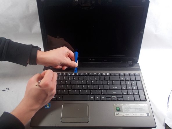

    • Flip the laptop back around so the Acer logo is facing upwards.
    • Open the laptop and using the iFixit opening tool, press the tabs in at the very top of the keyboard, in order to remove the keyboard.
  11. Acer Aspire 5750-6677 Motherboard Replacement: crwdns2935265:011crwdnd2935265:01crwdnd2935265:01crwdne2935265:0
    • Use the Phillips #0 screwdriver to remove six screws.
    • Pull the top off of the keyboard to expose the motherboard.
