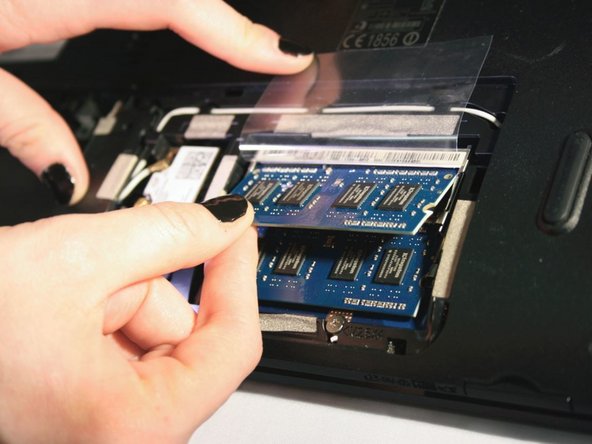

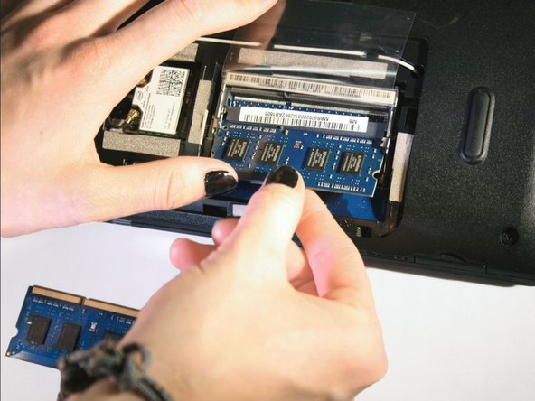

  5. Acer Aspire 5750-6667 Memory Replacement, RAM: crwdns2935265:05crwdnd2935265:01crwdnd2935265:03crwdne2935265:0 Acer Aspire 5750-6667 Memory Replacement, RAM: crwdns2935265:05crwdnd2935265:02crwdnd2935265:03crwdne2935265:0 Acer Aspire 5750-6667 Memory Replacement, RAM: crwdns2935265:05crwdnd2935265:03crwdnd2935265:03crwdne2935265:0
    • Lift the clear plastic flap and locate the pair of metal brackets that are holding the top RAM in place.
    • Using your thumbs, push the brackets away from the RAM . It should pop up when released.
    • You can now gently pull the top RAM out of the laptop.

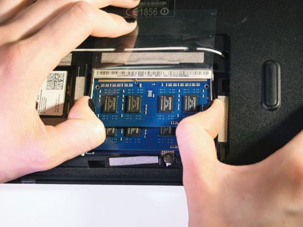

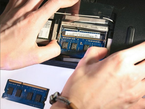

  6. Acer Aspire 5750-6667 Memory Replacement: crwdns2935265:06crwdnd2935265:01crwdnd2935265:03crwdne2935265:0 Acer Aspire 5750-6667 Memory Replacement: crwdns2935265:06crwdnd2935265:02crwdnd2935265:03crwdne2935265:0 Acer Aspire 5750-6667 Memory Replacement: crwdns2935265:06crwdnd2935265:03crwdnd2935265:03crwdne2935265:0
    • Locate the second pair of metal clasps holding the bottom RAM in place.
    • Using your thumbs, push the brackets away from the RAM . The RAM board should pop up when released.
    • You can now gently pull the top RAM out of the laptop. Repeat for any other RAM boards that may be in the device.
