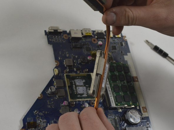

  24. Acer Aspire 5742 Heat Sink/Thermal Paste Replacement, CPU heatsink/thermal paste: crwdns2935265:024crwdnd2935265:01crwdnd2935265:02crwdne2935265:0 Acer Aspire 5742 Heat Sink/Thermal Paste Replacement, CPU heatsink/thermal paste: crwdns2935265:024crwdnd2935265:02crwdnd2935265:02crwdne2935265:0
    • Remove the 4 Phillips #0 screws from the heat sink.
    • The heat sink can now be removed from the motherboard and CPU.
    • Follow this great guide to re-apply your thermal paste- How to Apply Thermal Paste
