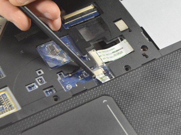

  19. Acer Aspire 5742 Cooling Fan Replacement: crwdns2935265:019crwdnd2935265:01crwdnd2935265:02crwdne2935265:0 Acer Aspire 5742 Cooling Fan Replacement: crwdns2935265:019crwdnd2935265:02crwdnd2935265:02crwdne2935265:0
    • Release the two ribbon cables from the ZIF connectors in the same fashion as in Step 11 with the black spudger.
    • Once the mechanism is released you may remove the cable by hand.
    • The plastic cover can now be easily lifted and removed from the rest of the laptop.
