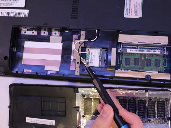

    • Locate your computers WIFI chip; it will have black and white wires attached to it.
  4. Acer Aspire 5741-5698 WIFI Chipset Replacement: crwdns2935265:04crwdnd2935265:01crwdnd2935265:03crwdne2935265:0 Acer Aspire 5741-5698 WIFI Chipset Replacement: crwdns2935265:04crwdnd2935265:02crwdnd2935265:03crwdne2935265:0 Acer Aspire 5741-5698 WIFI Chipset Replacement: crwdns2935265:04crwdnd2935265:03crwdnd2935265:03crwdne2935265:0
    • Using your fingers or a spudger, remove the black and white cables from the chip, at the connector.

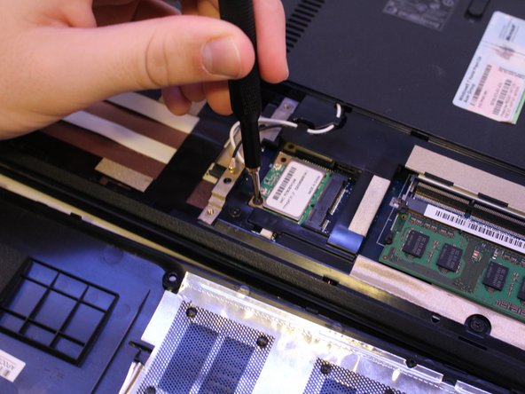

  5. Acer Aspire 5741-5698 WIFI Chipset Replacement: crwdns2935265:05crwdnd2935265:01crwdnd2935265:02crwdne2935265:0 Acer Aspire 5741-5698 WIFI Chipset Replacement: crwdns2935265:05crwdnd2935265:02crwdnd2935265:02crwdne2935265:0
    • Using the same JIS#0 screw driver remove the single small 1/4 inch long screw.

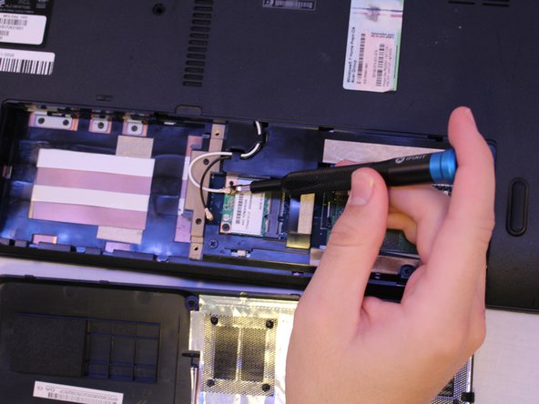

  6. Acer Aspire 5741-5698 WIFI Chipset Replacement: crwdns2935265:06crwdnd2935265:01crwdnd2935265:03crwdne2935265:0 Acer Aspire 5741-5698 WIFI Chipset Replacement: crwdns2935265:06crwdnd2935265:02crwdnd2935265:03crwdne2935265:0 Acer Aspire 5741-5698 WIFI Chipset Replacement: crwdns2935265:06crwdnd2935265:03crwdnd2935265:03crwdne2935265:0
    • Now that the chip is released just gently remove it from its connector seat.
