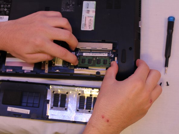

    • Flip the laptop over so the bottom side is facing up.
    • Remove the two Phillips screws that secure the bottom flap
  2. Acer Aspire 5741-5698 RAM Replacement: crwdns2935265:02crwdnd2935265:01crwdnd2935265:02crwdne2935265:0 Acer Aspire 5741-5698 RAM Replacement: crwdns2935265:02crwdnd2935265:02crwdnd2935265:02crwdne2935265:0
    • Lift the loosened bottom flap to expose the RAM chip.
  3. Acer Aspire 5741-5698 RAM Replacement: crwdns2935265:03crwdnd2935265:01crwdnd2935265:03crwdne2935265:0 Acer Aspire 5741-5698 RAM Replacement: crwdns2935265:03crwdnd2935265:02crwdnd2935265:03crwdne2935265:0 Acer Aspire 5741-5698 RAM Replacement: crwdns2935265:03crwdnd2935265:03crwdnd2935265:03crwdne2935265:0
    • Depress the two prongs holding the chip in and remove the chip.
    • Slide in a new chip, seating it so that it clicks and locks into position.
