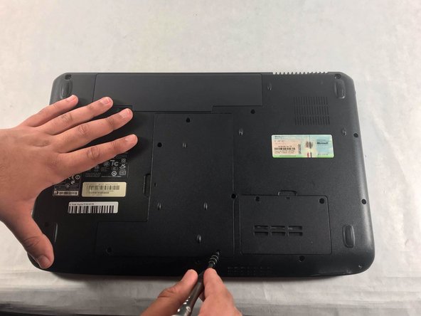

    • Flip over the device so the back is facing upward.
  5. Acer Aspire 5740-6378 WiFi Card Replacement: crwdns2935265:05crwdnd2935265:01crwdnd2935265:02crwdne2935265:0 Acer Aspire 5740-6378 WiFi Card Replacement: crwdns2935265:05crwdnd2935265:02crwdnd2935265:02crwdne2935265:0
    • Remove the five 8.7mm Phillips #0 screws securing the back panel.

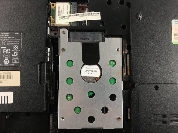

    • The WiFi card should be directly above the hard drive. Detach the two coaxial connectors attached to the WiFi card by pulling on them.
