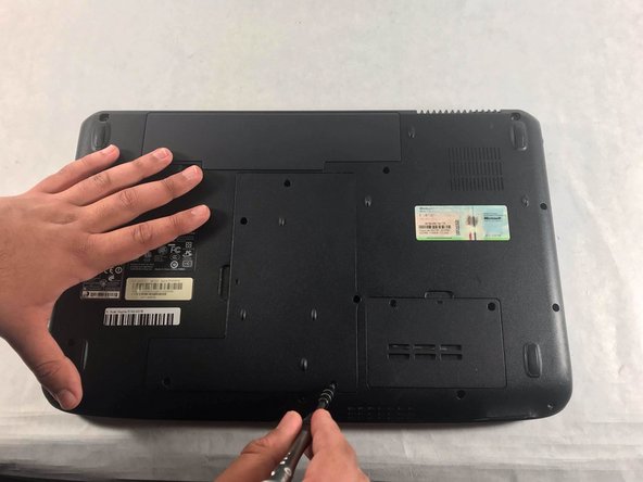

  5. Acer Aspire 5740-6378 Hard Drive Replacement: crwdns2935265:05crwdnd2935265:01crwdnd2935265:02crwdne2935265:0 Acer Aspire 5740-6378 Hard Drive Replacement: crwdns2935265:05crwdnd2935265:02crwdnd2935265:02crwdne2935265:0
    • Remove the five 8.7mm Phillips #0 screws securing the back panel.
  6. Acer Aspire 5740-6378 Hard Drive Replacement: crwdns2935265:06crwdnd2935265:01crwdnd2935265:02crwdne2935265:0 Acer Aspire 5740-6378 Hard Drive Replacement: crwdns2935265:06crwdnd2935265:02crwdnd2935265:02crwdne2935265:0
    • Remove the back panel using a spudger or other similar tool to lever it open to reveal the hard drive and other internal components.

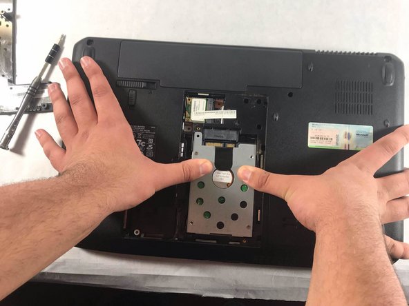

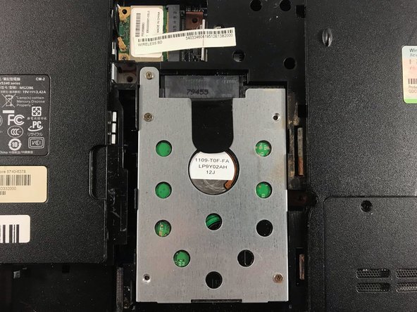

  7. Acer Aspire 5740-6378 Hard Drive Replacement: crwdns2935265:07crwdnd2935265:01crwdnd2935265:01crwdne2935265:0
    • Remove the single 3mm Phillips #0 screw that is holding the hard drive in place.
  8. Acer Aspire 5740-6378 Hard Drive Replacement: crwdns2935265:08crwdnd2935265:01crwdnd2935265:03crwdne2935265:0 Acer Aspire 5740-6378 Hard Drive Replacement: crwdns2935265:08crwdnd2935265:02crwdnd2935265:03crwdne2935265:0 Acer Aspire 5740-6378 Hard Drive Replacement: crwdns2935265:08crwdnd2935265:03crwdnd2935265:03crwdne2935265:0
    • Slide the hard drive away from the connector, then lift it to remove the drive.
