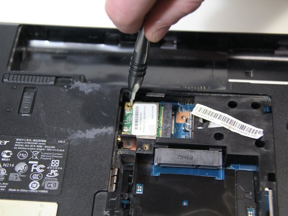

  13. Acer Aspire 5740-5780 WLAN Module Replacement, WLAN Module: crwdns2935265:013crwdnd2935265:01crwdnd2935265:01crwdne2935265:0
    • Disconnect the black and white antenna cables from the module.
    • Cables not shown.
  14. Acer Aspire 5740-5780 WLAN Module Replacement: crwdns2935265:014crwdnd2935265:01crwdnd2935265:02crwdne2935265:0 Acer Aspire 5740-5780 WLAN Module Replacement: crwdns2935265:014crwdnd2935265:02crwdnd2935265:02crwdne2935265:0
    • Remove one M2 x L4 screw, which is securing the WLAN Module.
  15. Acer Aspire 5740-5780 WLAN Module Replacement: crwdns2935265:015crwdnd2935265:01crwdnd2935265:01crwdne2935265:0
    • Carefully remove the module from the system, using plastic opening tools.
