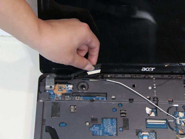

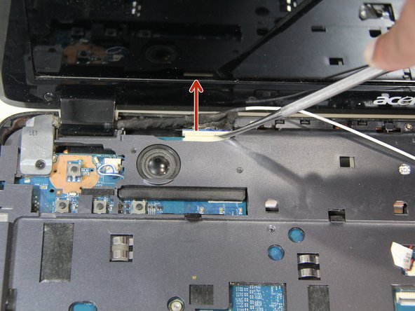

    • Retrieve the WLAN antenna wire from underneath the keyboard.
    • Detach the LCD cable from the main board.
