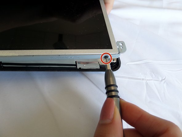

    • Locate six small screws, three on each side of the screen.
    • Remove all six screws with a #000 Phillips screwdriver.

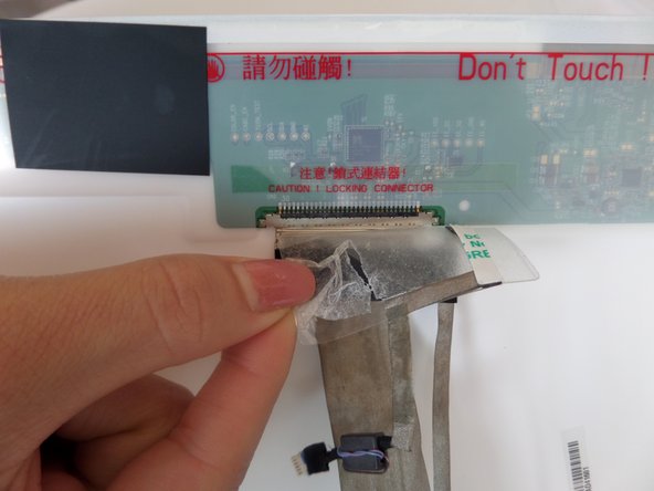

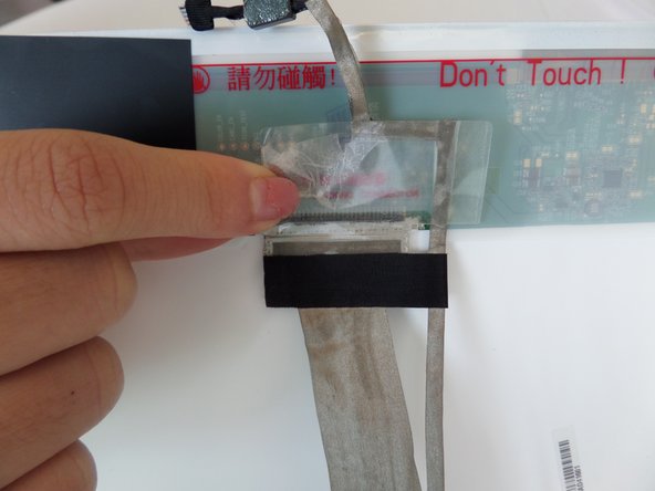

  12. Acer Aspire 5734z-4836 Screen Replacement: crwdns2935265:012crwdnd2935265:01crwdnd2935265:03crwdne2935265:0 Acer Aspire 5734z-4836 Screen Replacement: crwdns2935265:012crwdnd2935265:02crwdnd2935265:03crwdne2935265:0 Acer Aspire 5734z-4836 Screen Replacement: crwdns2935265:012crwdnd2935265:03crwdnd2935265:03crwdne2935265:0
    • Lift the screen up from the laptop and turn it around.
    • Gently peel back the tape located behind the screen.
  13. Acer Aspire 5734z-4836 Screen Replacement: crwdns2935265:013crwdnd2935265:01crwdnd2935265:02crwdne2935265:0 Acer Aspire 5734z-4836 Screen Replacement: crwdns2935265:013crwdnd2935265:02crwdnd2935265:02crwdne2935265:0

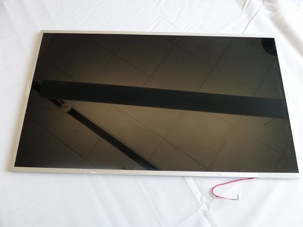

    • Pull the connector straight down to remove it.
    • You can now safely lift the screen out of the laptop.
