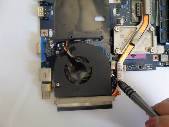

  31. Acer Aspire 5734z-4836 Fan Replacement, Fan: crwdns2935265:031crwdnd2935265:01crwdnd2935265:01crwdne2935265:0

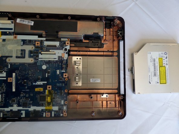

    • Position the back panel so that the circuit board is face-up.
    • Location of the fan is in the upper-left corner.
  32. Acer Aspire 5734z-4836 Fan Replacement: crwdns2935265:032crwdnd2935265:01crwdnd2935265:01crwdne2935265:0
    • Unscrew five screws from the circuit board using a #00 Phillips screwdriver.
    • Two screws are located below the fan, and three are along the circuit board's right edge.
    • Take note of the one black screw that goes in the lower-right corner.

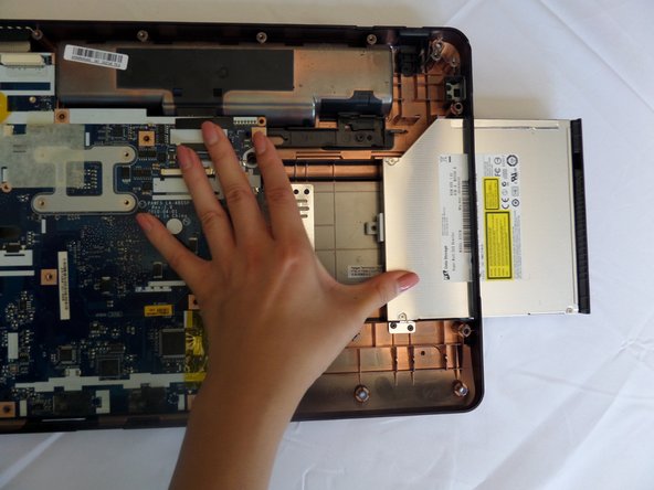

  33. Acer Aspire 5734z-4836 Fan Replacement: crwdns2935265:033crwdnd2935265:01crwdnd2935265:03crwdne2935265:0 Acer Aspire 5734z-4836 Fan Replacement: crwdns2935265:033crwdnd2935265:02crwdnd2935265:03crwdne2935265:0 Acer Aspire 5734z-4836 Fan Replacement: crwdns2935265:033crwdnd2935265:03crwdnd2935265:03crwdne2935265:0
    • The large, silver box next to the circuit board is the optical disk drive, gently slide to the right to remove it.
    • Do not apply too much pressure on the optical disk drive, as you may risk damaging the disk drive's connector.
  34. Acer Aspire 5734z-4836 Fan Replacement: crwdns2935265:034crwdnd2935265:01crwdnd2935265:03crwdne2935265:0 Acer Aspire 5734z-4836 Fan Replacement: crwdns2935265:034crwdnd2935265:02crwdnd2935265:03crwdne2935265:0 Acer Aspire 5734z-4836 Fan Replacement: crwdns2935265:034crwdnd2935265:03crwdnd2935265:03crwdne2935265:0
    • Lift the circuit board out of the back panel and turn it over so the fan is facing up.
  35. Acer Aspire 5734z-4836 Fan Replacement: crwdns2935265:035crwdnd2935265:01crwdnd2935265:02crwdne2935265:0 Acer Aspire 5734z-4836 Fan Replacement: crwdns2935265:035crwdnd2935265:02crwdnd2935265:02crwdne2935265:0
    • Locate the three screws around the fan
    • Gently extract three fan screws using #0 Phillips.
  36. Acer Aspire 5734z-4836 Fan Replacement: crwdns2935265:036crwdnd2935265:01crwdnd2935265:03crwdne2935265:0 Acer Aspire 5734z-4836 Fan Replacement: crwdns2935265:036crwdnd2935265:02crwdnd2935265:03crwdne2935265:0 Acer Aspire 5734z-4836 Fan Replacement: crwdns2935265:036crwdnd2935265:03crwdnd2935265:03crwdne2935265:0
    • Disconnect the white fan connector.
    • Grip gently the wire and pull the wires up toward you.
  37. Acer Aspire 5734z-4836 Fan Replacement: crwdns2935265:037crwdnd2935265:01crwdnd2935265:01crwdne2935265:0
    • Remove the fan from the circuit board.
    • Due to the accumulated dust inside the fan, you may want to use a small brush to clean off dust.
