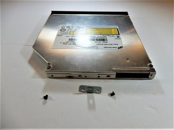

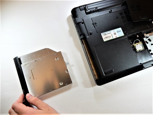

    • Unscrew the two .8 centimeter screws on the bottom plate with the PH #0 screwdriver.
  2. Acer Aspire 5534-1146 Disc Drive  Replacement: crwdns2935265:02crwdnd2935265:01crwdnd2935265:02crwdne2935265:0 Acer Aspire 5534-1146 Disc Drive  Replacement: crwdns2935265:02crwdnd2935265:02crwdnd2935265:02crwdne2935265:0
    • Using your fingers, or the blue plastic spudger tool if needed, remove the plate.
    • Then proceed to unscrew the .4 centimeter Phillips screw on the left side.
  3. Acer Aspire 5534-1146 Disc Drive  Replacement: crwdns2935265:03crwdnd2935265:01crwdnd2935265:02crwdne2935265:0 Acer Aspire 5534-1146 Disc Drive  Replacement: crwdns2935265:03crwdnd2935265:02crwdnd2935265:02crwdne2935265:0
    • You can now pull the disk drive out by hand.
  4. Acer Aspire 5534-1146 Disc Drive  Replacement: crwdns2935265:04crwdnd2935265:01crwdnd2935265:02crwdne2935265:0 Acer Aspire 5534-1146 Disc Drive  Replacement: crwdns2935265:04crwdnd2935265:02crwdnd2935265:02crwdne2935265:0
    • If needed, the small plate can be removed by unscrewing the two .4 centimeter Phillips screws.
