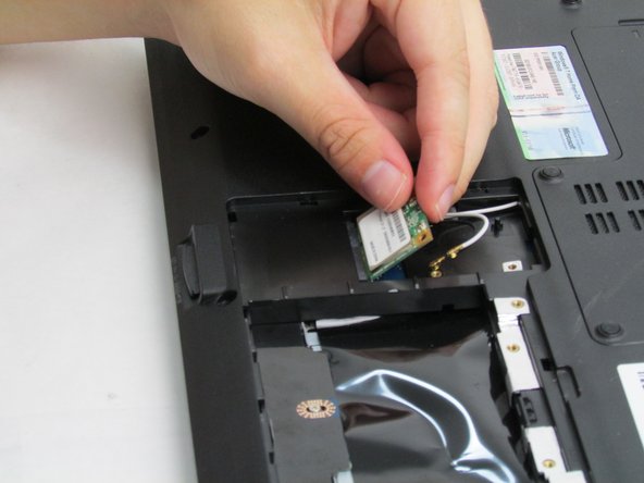

  3. Acer Aspire 5534-1096 Wi-Fi Chip Replacement: crwdns2935265:03crwdnd2935265:01crwdnd2935265:02crwdne2935265:0 Acer Aspire 5534-1096 Wi-Fi Chip Replacement: crwdns2935265:03crwdnd2935265:02crwdnd2935265:02crwdne2935265:0
    • Remove the Phillips #00 screw from the upper right corner of the Wi-Fi chip.
    • Using the tweezers, disconnect the black and white wires.

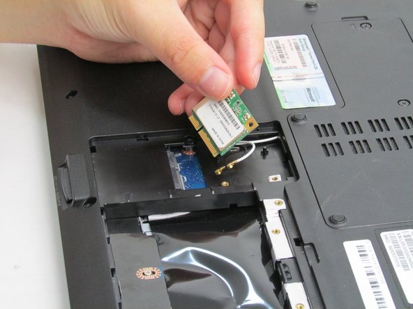

  4. Acer Aspire 5534-1096 Wi-Fi Chip Replacement: crwdns2935265:04crwdnd2935265:01crwdnd2935265:03crwdne2935265:0 Acer Aspire 5534-1096 Wi-Fi Chip Replacement: crwdns2935265:04crwdnd2935265:02crwdnd2935265:03crwdne2935265:0 Acer Aspire 5534-1096 Wi-Fi Chip Replacement: crwdns2935265:04crwdnd2935265:03crwdnd2935265:03crwdne2935265:0
    • Use your fingers to remove the Wi-Fi chip from the laptop.
