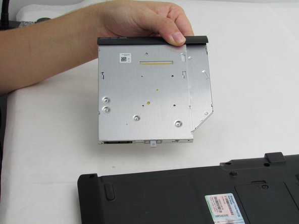

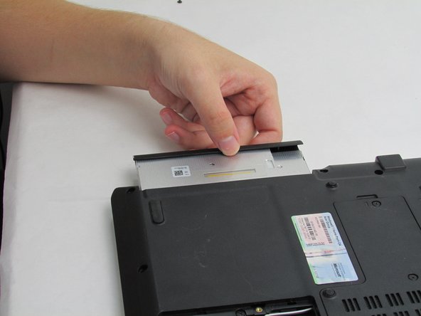

  4. Acer Aspire 5534-1096 CD Drive Replacement: crwdns2935265:04crwdnd2935265:01crwdnd2935265:03crwdne2935265:0 Acer Aspire 5534-1096 CD Drive Replacement: crwdns2935265:04crwdnd2935265:02crwdnd2935265:03crwdne2935265:0 Acer Aspire 5534-1096 CD Drive Replacement: crwdns2935265:04crwdnd2935265:03crwdnd2935265:03crwdne2935265:0
    • Use the spudger to release the CD drive by placing it between the lip of the drive and the rest of the device.
