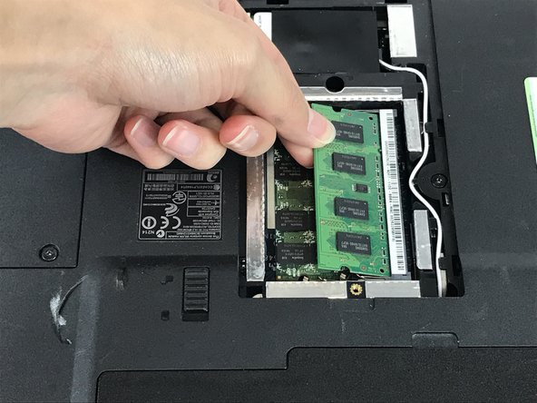

    • Orient the device so that it is upside down facing towards you. The ram panel is in the middle of the device.
    • The screw is at the bottom of the panel.
  2. Acer Aspire 5517-1127 RAM Replacement: crwdns2935265:02crwdnd2935265:01crwdnd2935265:02crwdne2935265:0 Acer Aspire 5517-1127 RAM Replacement: crwdns2935265:02crwdnd2935265:02crwdnd2935265:02crwdne2935265:0
    • Using a Phillips screwdriver (PH1), unscrew the screw from the panel.
    • Pull the panel away from the device as shown.
  3. Acer Aspire 5517-1127 RAM Replacement: crwdns2935265:03crwdnd2935265:01crwdnd2935265:01crwdne2935265:0
    • The two tabs are at the top and bottom of the case as shown.
  4. Acer Aspire 5517-1127 RAM Replacement: crwdns2935265:04crwdnd2935265:01crwdnd2935265:02crwdne2935265:0 Acer Aspire 5517-1127 RAM Replacement: crwdns2935265:04crwdnd2935265:02crwdnd2935265:02crwdne2935265:0
    • Using two fingers, push the tabs inward to release the RAM from its casing.
    • Pull the RAM towards you to remove it.
  5. Acer Aspire 5517-1127 RAM Replacement: crwdns2935265:05crwdnd2935265:01crwdnd2935265:01crwdne2935265:0
    • The RAM is now removed.
