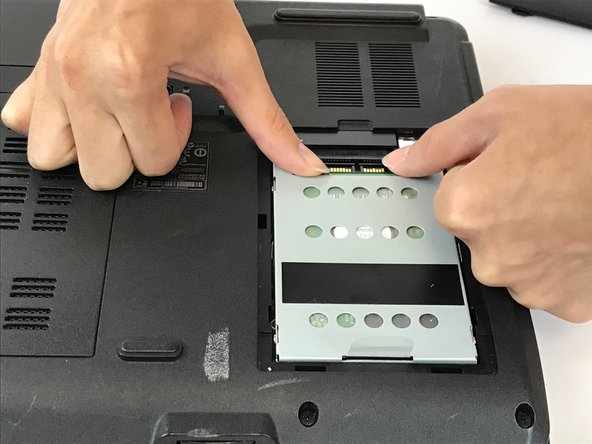

    • Orient the laptop so that it is upside down facing away from you. The hard drive panel is on the right.
    • The two screws are at the top of the panel.
  2. Acer Aspire 5517-1127 Hard Drive Replacement: crwdns2935265:02crwdnd2935265:01crwdnd2935265:02crwdne2935265:0 Acer Aspire 5517-1127 Hard Drive Replacement: crwdns2935265:02crwdnd2935265:02crwdnd2935265:02crwdne2935265:0
    • Using a Phillips screwdriver (PH1), unscrew each screw from the panel.
    • Pull the panel away from the device as shown.
  3. Acer Aspire 5517-1127 Hard Drive Replacement: crwdns2935265:03crwdnd2935265:01crwdnd2935265:02crwdne2935265:0 Acer Aspire 5517-1127 Hard Drive Replacement: crwdns2935265:03crwdnd2935265:02crwdnd2935265:02crwdne2935265:0
    • Push the hard drive out of its housing as shown.
  4. Acer Aspire 5517-1127 Hard Drive Replacement: crwdns2935265:04crwdnd2935265:01crwdnd2935265:01crwdne2935265:0
    • The hard drive is now removed.
