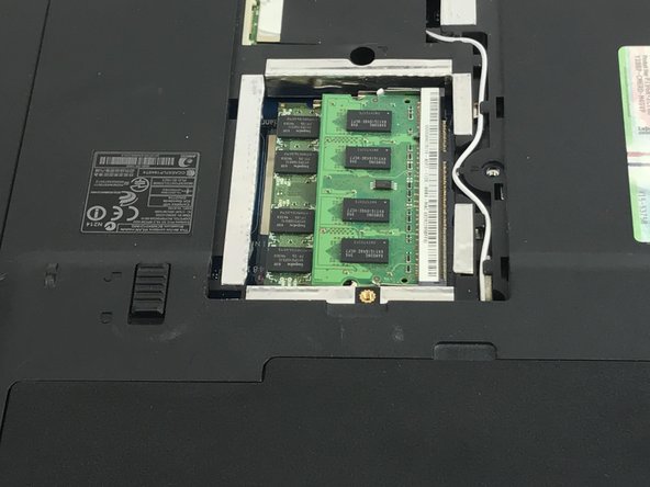

    • Orient the laptop so that its upside down facing away from you.
    • The screw is at the bottom of the RAM panel.
  2. Acer Aspire 5517-1127 Disk Drive Replacement: crwdns2935265:02crwdnd2935265:01crwdnd2935265:02crwdne2935265:0 Acer Aspire 5517-1127 Disk Drive Replacement: crwdns2935265:02crwdnd2935265:02crwdnd2935265:02crwdne2935265:0
    • Using a Phillips screwdriver (PH1), unscrew the screw from the panel.
    • Pull the panel away from the device as shown.

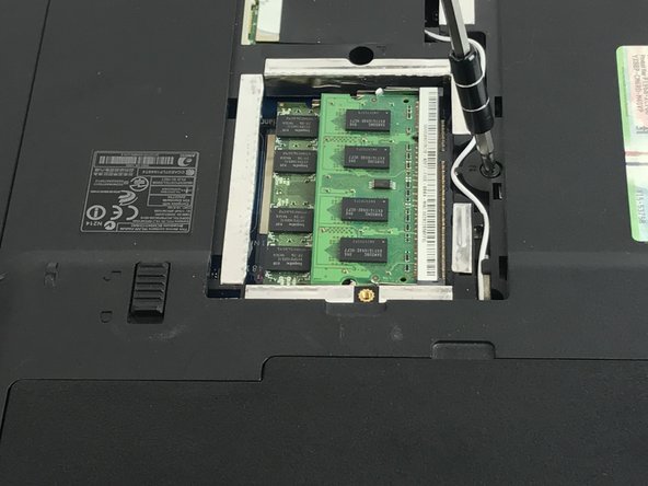

  3. Acer Aspire 5517-1127 Disk Drive Replacement: crwdns2935265:03crwdnd2935265:01crwdnd2935265:03crwdne2935265:0 Acer Aspire 5517-1127 Disk Drive Replacement: crwdns2935265:03crwdnd2935265:02crwdnd2935265:03crwdne2935265:0 Acer Aspire 5517-1127 Disk Drive Replacement: crwdns2935265:03crwdnd2935265:03crwdnd2935265:03crwdne2935265:0
    • The screw to the right of the inner RAM casing is shown.
    • Using the same Phillips screwdriver (PH1), unscrew the screw.

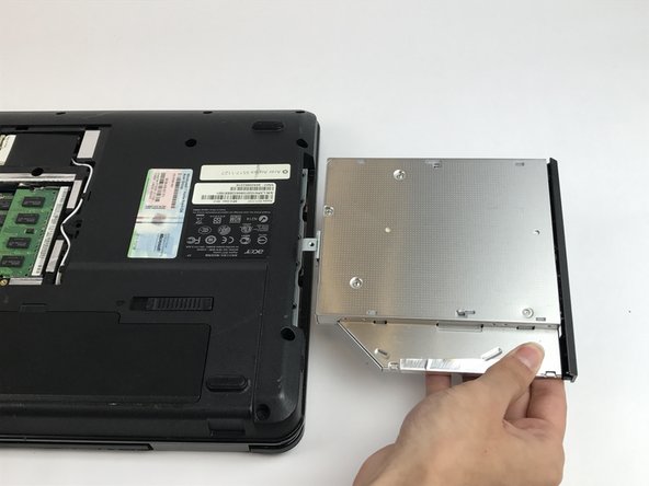

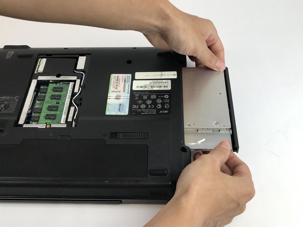

  4. Acer Aspire 5517-1127 Disk Drive Replacement: crwdns2935265:04crwdnd2935265:01crwdnd2935265:03crwdne2935265:0 Acer Aspire 5517-1127 Disk Drive Replacement: crwdns2935265:04crwdnd2935265:02crwdnd2935265:03crwdne2935265:0 Acer Aspire 5517-1127 Disk Drive Replacement: crwdns2935265:04crwdnd2935265:03crwdnd2935265:03crwdne2935265:0
    • Gently push the disk drive away from the device as demonstrated.
    • The disk drive will come out with the screw removed from the RAM casing.
