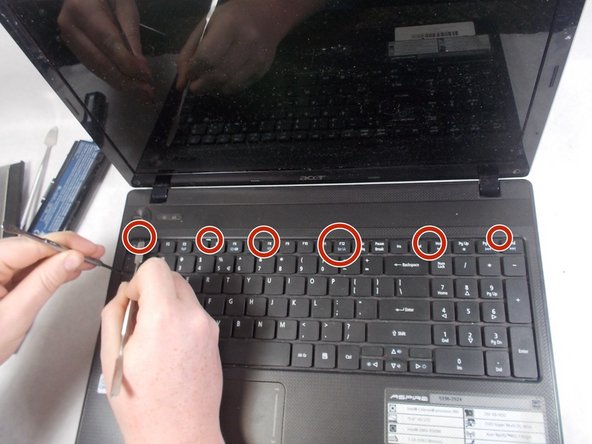

    • Open the laptop.
    • Wedge the spudger or iFixit opening tool between the side of the keyboard and the laptop and apply a slight amount of upward pressure.
    • Push in the latches at the top of the keyboard using the spudger to release that part of the keyboard, and start to lift up the keyboard more and more as you push in the latches.

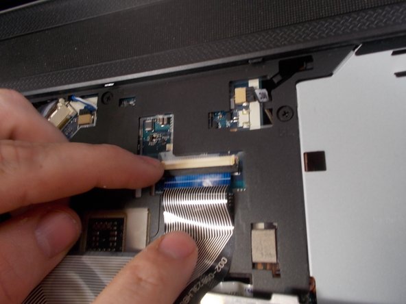

    • Remove the ribbon cable that connects the keyboard to the motherboard by pushing the black latch downward and then pulling the cable out.
  9. Acer Aspire 5336-2524 Motherboard Replacement: crwdns2935265:09crwdnd2935265:01crwdnd2935265:01crwdne2935265:0
    • Remove the eight M2.5x8 screws with a Phillips #0 screwdriver.
    • Remove the cables indicated by simply pulling them out.
    • Remove the cables by lifting up on the black latch and pulling the ribbon out.
