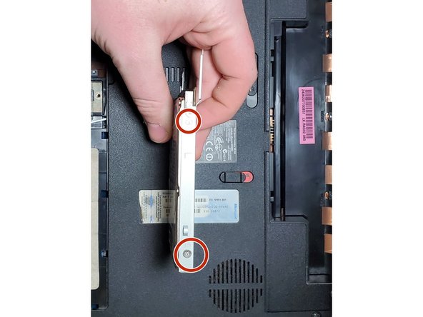

  4. Acer Aspire 5336-2524 Hard drive Replacement: crwdns2935265:04crwdnd2935265:01crwdnd2935265:03crwdne2935265:0 Acer Aspire 5336-2524 Hard drive Replacement: crwdns2935265:04crwdnd2935265:02crwdnd2935265:03crwdne2935265:0 Acer Aspire 5336-2524 Hard drive Replacement: crwdns2935265:04crwdnd2935265:03crwdnd2935265:03crwdne2935265:0
    • Remove both M2.5x8 screws on each side of the hard drive caddy, using a Phillips #0 screwdriver.
    • Lift the hard drive out of the caddy.
