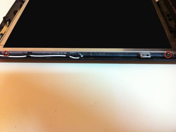

    • Remove the 4 screws in the side of the LCD. Screen should be able to come of the frame

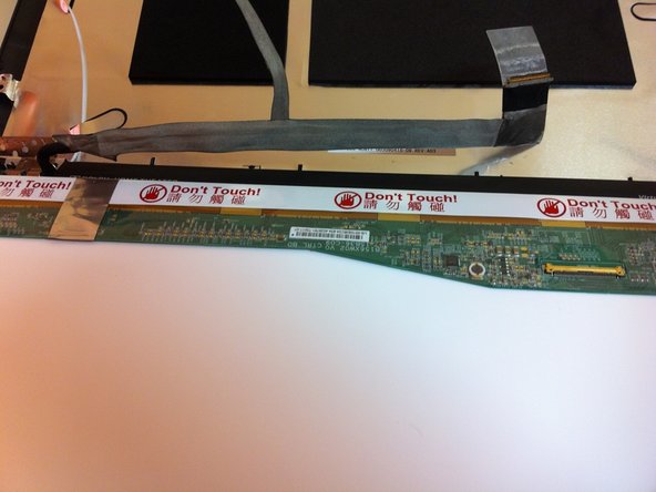

    • Remove the tape, and unplug the display cable.
    • Unstick the cable from the back of the LCD, and now the LCD is free to come off. You are ready to install a new one
    • Try not to damage this cable, otherwise replacing it would be so much pain.
