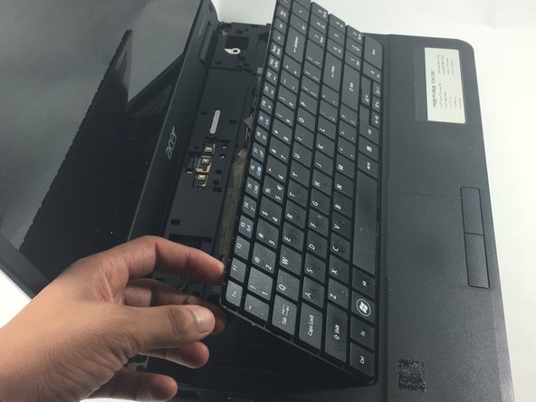

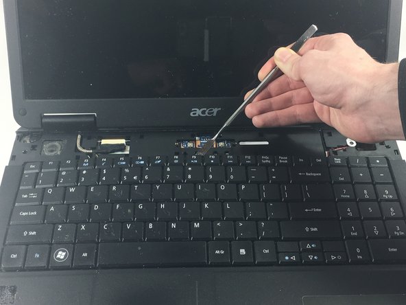

  5. Acer Aspire 5334-2581 Keyboard Replacement, Keyboard: crwdns2935265:05crwdnd2935265:01crwdnd2935265:03crwdne2935265:0 Acer Aspire 5334-2581 Keyboard Replacement, Keyboard: crwdns2935265:05crwdnd2935265:02crwdnd2935265:03crwdne2935265:0 Acer Aspire 5334-2581 Keyboard Replacement, Keyboard: crwdns2935265:05crwdnd2935265:03crwdnd2935265:03crwdne2935265:0
    • The keyboard is held underneath a plastic cover. remove this cover with a spudger.
    • Using a spudger, apply it underneath the keyboard and lift it up.

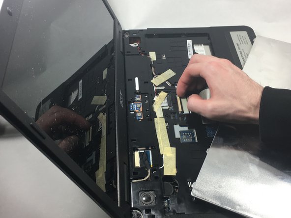

  6. Acer Aspire 5334-2581 Keyboard Replacement: crwdns2935265:06crwdnd2935265:01crwdnd2935265:02crwdne2935265:0 Acer Aspire 5334-2581 Keyboard Replacement: crwdns2935265:06crwdnd2935265:02crwdnd2935265:02crwdne2935265:0
    • Disconnect the keyboard flex cable, and now you are ready to install a new keyboard.
    • Take extra care, and try not to break the the latch that holds the cable in place.
