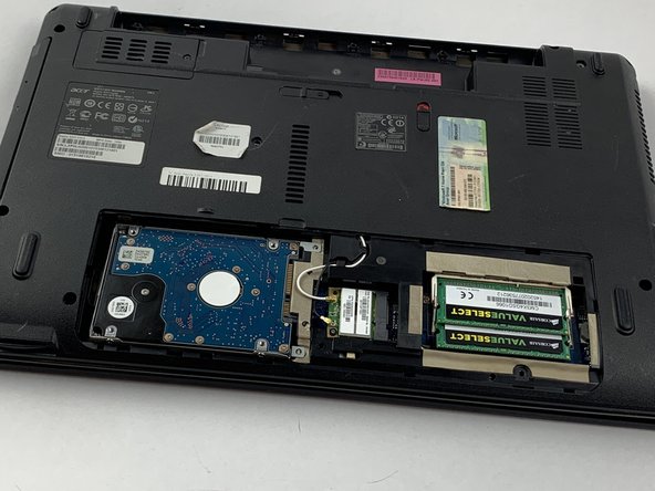

  5. Acer Aspire 5251-1513 Hard Drive Replacement, Hard Drive: crwdns2935265:05crwdnd2935265:01crwdnd2935265:01crwdne2935265:0
    • Unscrew the two 8.6 mm screws using a Phillips #0 screwdriver.
  6. Acer Aspire 5251-1513 Hard Drive Replacement: crwdns2935265:06crwdnd2935265:01crwdnd2935265:02crwdne2935265:0 Acer Aspire 5251-1513 Hard Drive Replacement: crwdns2935265:06crwdnd2935265:02crwdnd2935265:02crwdne2935265:0
    • Use a spudger or plastic opening tool to lift the panel up. Then remove the panel entirely with your hands.
  7. Acer Aspire 5251-1513 Hard Drive Replacement: crwdns2935265:07crwdnd2935265:01crwdnd2935265:02crwdne2935265:0 Acer Aspire 5251-1513 Hard Drive Replacement: crwdns2935265:07crwdnd2935265:02crwdnd2935265:02crwdne2935265:0
    • Slide the hard drive to the left until it clicks and then pull it out completely.

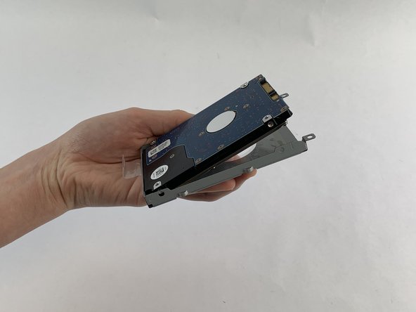

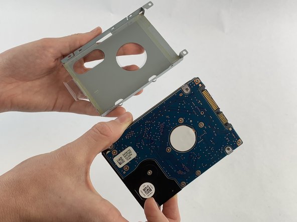

  8. Acer Aspire 5251-1513 Hard Drive Replacement: crwdns2935265:08crwdnd2935265:01crwdnd2935265:03crwdne2935265:0 Acer Aspire 5251-1513 Hard Drive Replacement: crwdns2935265:08crwdnd2935265:02crwdnd2935265:03crwdne2935265:0 Acer Aspire 5251-1513 Hard Drive Replacement: crwdns2935265:08crwdnd2935265:03crwdnd2935265:03crwdne2935265:0
    • Unscrew the four 3.6 mm screws on either side of the casing with the Phillips #0 screwdriver.
    • Remove the hard drive out of its casing.
    • Be Gentle with the hard rive, only touch the edges.
