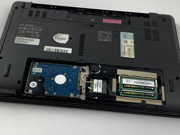

  5. Acer Aspire 5251-1513 Display Assembly Replacement, Display Assembly: crwdns2935265:05crwdnd2935265:01crwdnd2935265:01crwdne2935265:0
    • Unscrew the 8.6 mm screws on the back panel with a Phillips #0 screwdriver.
  6. Acer Aspire 5251-1513 Display Assembly Replacement: crwdns2935265:06crwdnd2935265:01crwdnd2935265:02crwdne2935265:0 Acer Aspire 5251-1513 Display Assembly Replacement: crwdns2935265:06crwdnd2935265:02crwdnd2935265:02crwdne2935265:0
    • Using a plastic opening tool, lift up the panel and remove it completely.

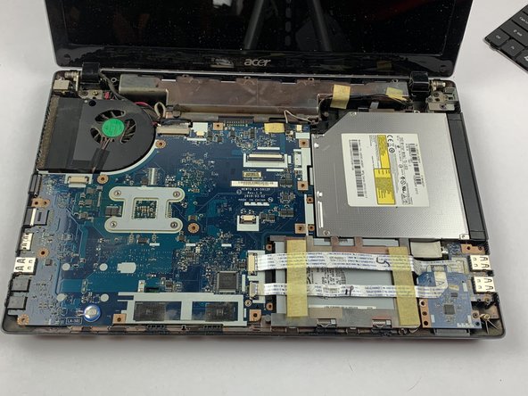

  14. Acer Aspire 5251-1513 Display Assembly Replacement: crwdns2935265:014crwdnd2935265:01crwdnd2935265:01crwdne2935265:0
    • Locate the 4 connectors that must also be disconnected.
  15. Acer Aspire 5251-1513 Display Assembly Replacement: crwdns2935265:015crwdnd2935265:01crwdnd2935265:01crwdne2935265:0
    • For the Power button cable and touchpad cable, please disconnect the connector using tweezers to pull down the brown tabs.
    • For the smaller right and left speaker cables, pull out the black tab completely also using tweezers.
  16. Acer Aspire 5251-1513 Display Assembly Replacement: crwdns2935265:016crwdnd2935265:01crwdnd2935265:02crwdne2935265:0 Acer Aspire 5251-1513 Display Assembly Replacement: crwdns2935265:016crwdnd2935265:02crwdnd2935265:02crwdne2935265:0
    • Using a plastic spudger or your hands, carefully lift up the corner of the top panel.
    • Continue to lift the panel until it is removed completely.

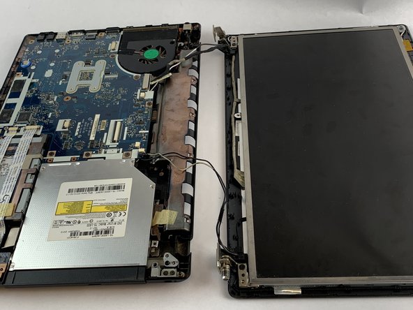

  17. Acer Aspire 5251-1513 Display Assembly Replacement: crwdns2935265:017crwdnd2935265:01crwdnd2935265:01crwdne2935265:0
    • Locate the video cable connector keeping the screen connected to the motherboard.
  18. Acer Aspire 5251-1513 Display Assembly Replacement: crwdns2935265:018crwdnd2935265:01crwdnd2935265:02crwdne2935265:0 Acer Aspire 5251-1513 Display Assembly Replacement: crwdns2935265:018crwdnd2935265:02crwdnd2935265:02crwdne2935265:0
    • Unscrew the 8.6 mm bottom screws on the both hinges to separate the screen from the rest.
    • The computer is still connected to the backside of the motherboard so do not yank it off completely.
  19. Acer Aspire 5251-1513 Display Assembly Replacement: crwdns2935265:019crwdnd2935265:01crwdnd2935265:01crwdne2935265:0
    • Remove the circle sticker and unscrew the 6.7 mm screws with a Phillips #0 screwdriver.

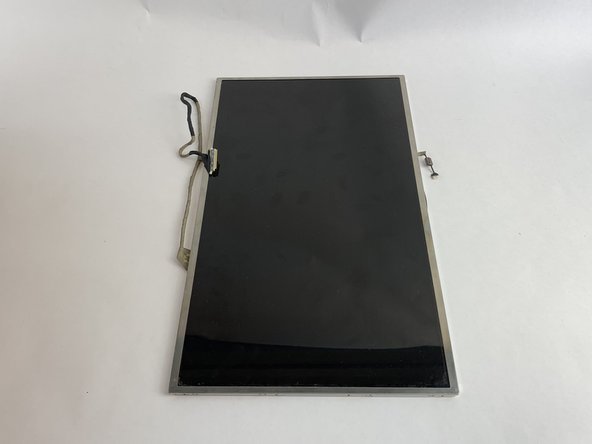

  20. Acer Aspire 5251-1513 Display Assembly Replacement: crwdns2935265:020crwdnd2935265:01crwdnd2935265:01crwdne2935265:0
    • Peel back the screen carefully using a plastic spudger or your hands.
  21. Acer Aspire 5251-1513 Display Assembly Replacement: crwdns2935265:021crwdnd2935265:01crwdnd2935265:01crwdne2935265:0
    • Using a Phillips #0 screwdriver, remove all six 3.6mm screws on the sides of the screen.
  22. Acer Aspire 5251-1513 Display Assembly Replacement: crwdns2935265:022crwdnd2935265:01crwdnd2935265:01crwdne2935265:0
    • Disconnect the webcam connector by gently pulling on the tabs using your hands or tweezers.
  23. Acer Aspire 5251-1513 Display Assembly Replacement: crwdns2935265:023crwdnd2935265:01crwdnd2935265:02crwdne2935265:0 Acer Aspire 5251-1513 Display Assembly Replacement: crwdns2935265:023crwdnd2935265:02crwdnd2935265:02crwdne2935265:0
    • Remove the screen completely.
