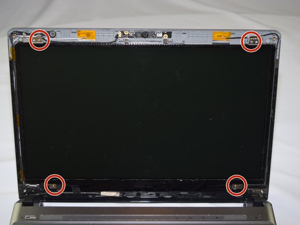

    • Carefully pull the bevel (frame) off of the screen
  6. Acer Aspire 4810TZ-4120 Screen Replacement: crwdns2935265:06crwdnd2935265:01crwdnd2935265:03crwdne2935265:0 Acer Aspire 4810TZ-4120 Screen Replacement: crwdns2935265:06crwdnd2935265:02crwdnd2935265:03crwdne2935265:0 Acer Aspire 4810TZ-4120 Screen Replacement: crwdns2935265:06crwdnd2935265:03crwdnd2935265:03crwdne2935265:0

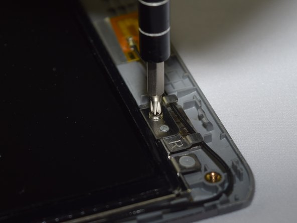

    • Locate the four screws that are holding the screen in place
    • Remove the screws

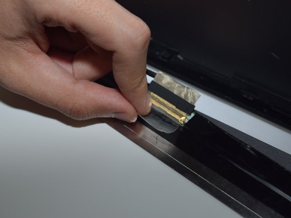

    • Locate the connector between the screen and the computer
    • Remove any tape
  9. Acer Aspire 4810TZ-4120 Screen Replacement: crwdns2935265:09crwdnd2935265:01crwdnd2935265:01crwdne2935265:0
    • Gently pull the connector off of the screen
    • The screen can now be replaced with a new one
