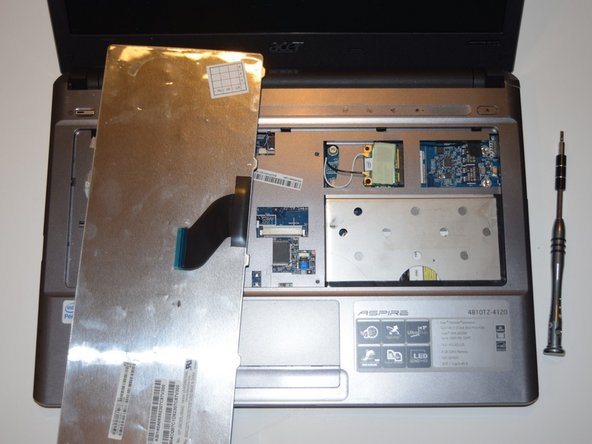

    • Locate the five (5) tabs at the top of the keyboard that are holding it in place
    • The 2nd and 3rd pictures are close ups of the tabs
  2. Acer Aspire 4810TZ-4120 Keyboard Replacement: crwdns2935265:02crwdnd2935265:01crwdnd2935265:02crwdne2935265:0 Acer Aspire 4810TZ-4120 Keyboard Replacement: crwdns2935265:02crwdnd2935265:02crwdnd2935265:02crwdne2935265:0
    • The first picture shows the notches in the keyboard that the tabs to into to hold it in place. You cannot see these until the keyboard is removed
    • Insert the flat part of the Spudger tool into one of the holes in front of the tab
    • Push the tab back so it is no longer holding the keyboard.
    • Repeat this step for all of the tabs
  3. Acer Aspire 4810TZ-4120 Keyboard Replacement: crwdns2935265:03crwdnd2935265:01crwdnd2935265:02crwdne2935265:0 Acer Aspire 4810TZ-4120 Keyboard Replacement: crwdns2935265:03crwdnd2935265:02crwdnd2935265:02crwdne2935265:0
    • Lay the keyboard upside down
    • Remove any tape that is on the connector with tweezers
    • Gently remove the connector that is on the ribbon cable from the back of the keyboard
    • Your keyboard is now ready to be replaced with a new one
