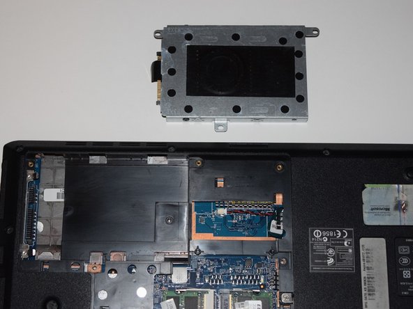

    • Lay the laptop upside down.
    • Locate and unscrew the seven phillips head screws.
  2. Acer Aspire 4810TZ-4120 Hard Drive Replacement: crwdns2935265:02crwdnd2935265:01crwdnd2935265:01crwdne2935265:0
    • Remove the cover panel from the laptop
  3. Acer Aspire 4810TZ-4120 Hard Drive Replacement: crwdns2935265:03crwdnd2935265:01crwdnd2935265:03crwdne2935265:0 Acer Aspire 4810TZ-4120 Hard Drive Replacement: crwdns2935265:03crwdnd2935265:02crwdnd2935265:03crwdne2935265:0 Acer Aspire 4810TZ-4120 Hard Drive Replacement: crwdns2935265:03crwdnd2935265:03crwdnd2935265:03crwdne2935265:0
    • Remove the hard drive from the laptop by using a Spudger tool to pry it out.

Yes, but how do you get the hard drive out of its carrier, for example in order to replace it with an SSD?
