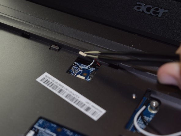

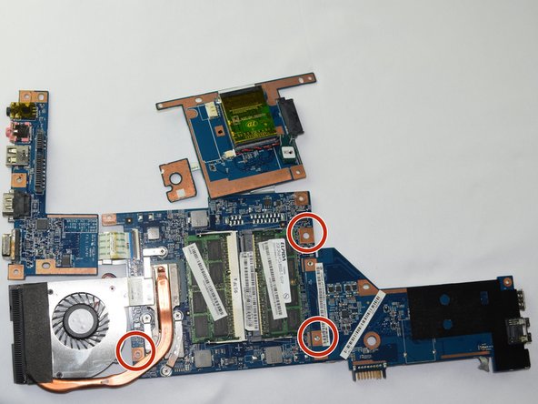

  3. Acer Aspire 4810TZ-4120 Fan Replacement: crwdns2935265:03crwdnd2935265:01crwdnd2935265:03crwdne2935265:0 Acer Aspire 4810TZ-4120 Fan Replacement: crwdns2935265:03crwdnd2935265:02crwdnd2935265:03crwdne2935265:0 Acer Aspire 4810TZ-4120 Fan Replacement: crwdns2935265:03crwdnd2935265:03crwdnd2935265:03crwdne2935265:0

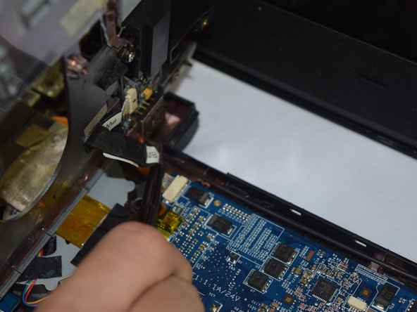

    • Get a pair of tweezers
    • Start to detach the wires that are connected to the computer
    • Get a screwdriver and unscrew the screws that are circled in the picture

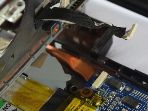

  4. Acer Aspire 4810TZ-4120 Fan Replacement: crwdns2935265:04crwdnd2935265:01crwdnd2935265:03crwdne2935265:0 Acer Aspire 4810TZ-4120 Fan Replacement: crwdns2935265:04crwdnd2935265:02crwdnd2935265:03crwdne2935265:0 Acer Aspire 4810TZ-4120 Fan Replacement: crwdns2935265:04crwdnd2935265:03crwdnd2935265:03crwdne2935265:0
    • Repeat Step 3 for detaching the rest of the tape
    • Disconnect all wires from the boards

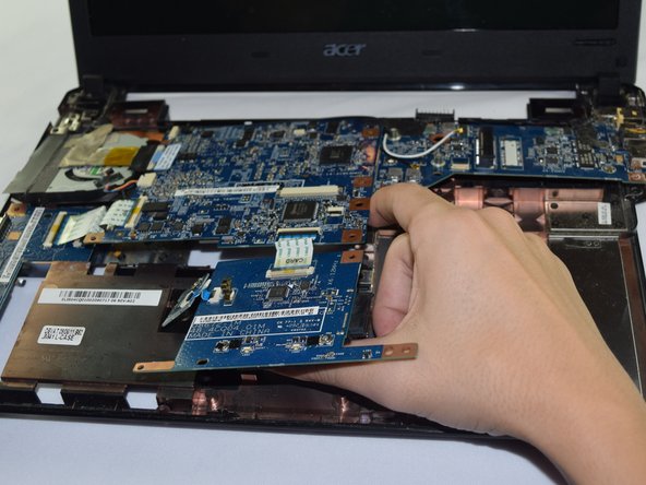

  6. Acer Aspire 4810TZ-4120 Fan Replacement: crwdns2935265:06crwdnd2935265:01crwdnd2935265:03crwdne2935265:0 Acer Aspire 4810TZ-4120 Fan Replacement: crwdns2935265:06crwdnd2935265:02crwdnd2935265:03crwdne2935265:0 Acer Aspire 4810TZ-4120 Fan Replacement: crwdns2935265:06crwdnd2935265:03crwdnd2935265:03crwdne2935265:0
    • Remove the three screws
    • Pull the boards upward
    • Flip the boards upside down
    • The screws and the board were removed so that the holes could be better shown

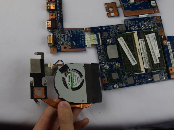

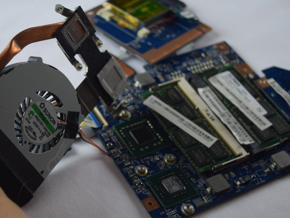

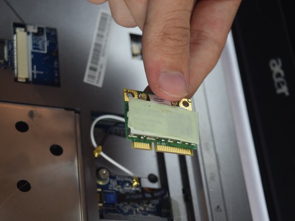

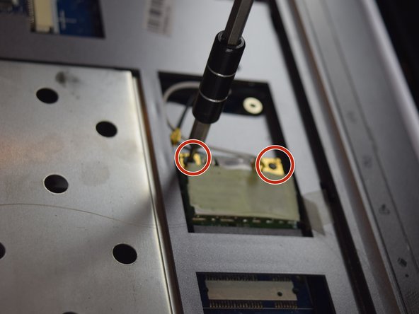

    • Remove the four (4) screws that are holding the CPU's cover on
  8. Acer Aspire 4810TZ-4120 Fan Replacement: crwdns2935265:08crwdnd2935265:01crwdnd2935265:02crwdne2935265:0 Acer Aspire 4810TZ-4120 Fan Replacement: crwdns2935265:08crwdnd2935265:02crwdnd2935265:02crwdne2935265:0
    • Gently detached the wire that is connected to the computer
