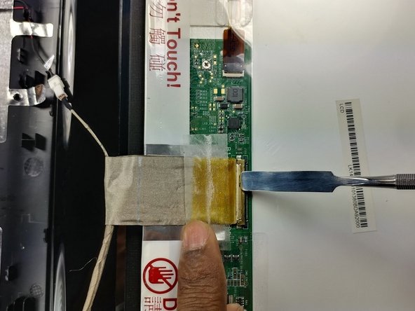

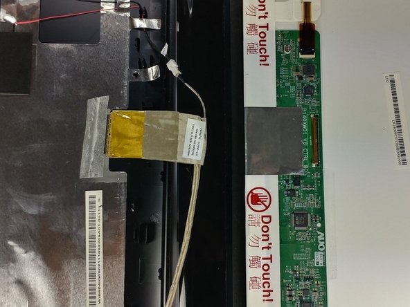

  8. Acer Aspire 4743-6481 Screen Replacement: crwdns2935265:08crwdnd2935265:01crwdnd2935265:03crwdne2935265:0 Acer Aspire 4743-6481 Screen Replacement: crwdns2935265:08crwdnd2935265:02crwdnd2935265:03crwdne2935265:0 Acer Aspire 4743-6481 Screen Replacement: crwdns2935265:08crwdnd2935265:03crwdnd2935265:03crwdne2935265:0
    • Gently remove the tape that covers the connector cable, as highlighted in the first picture.
    • With a flat tool, gently disconnect the connector cable from the damaged screen.
