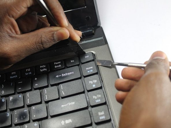

  5. Acer Aspire 4743-6481 Keyboard Replacement: crwdns2935265:05crwdnd2935265:01crwdnd2935265:02crwdne2935265:0 Acer Aspire 4743-6481 Keyboard Replacement: crwdns2935265:05crwdnd2935265:02crwdnd2935265:02crwdne2935265:0
    • Turn the laptop over and open it.
    • Use flat edged tools to gently separate the keyboard from the laptop. It should snap off with a small amount of force.
    • Be sure to push the small tabs along the top of the keyboard, while lifting to successfully free the keyboard.
  6. Acer Aspire 4743-6481 Keyboard Replacement: crwdns2935265:06crwdnd2935265:01crwdnd2935265:01crwdne2935265:0
    • Gently lift away the keyboard, making sure not to damage the data cable or the connector.
    • The connection is located beneath the bottom center of the keyboard.
