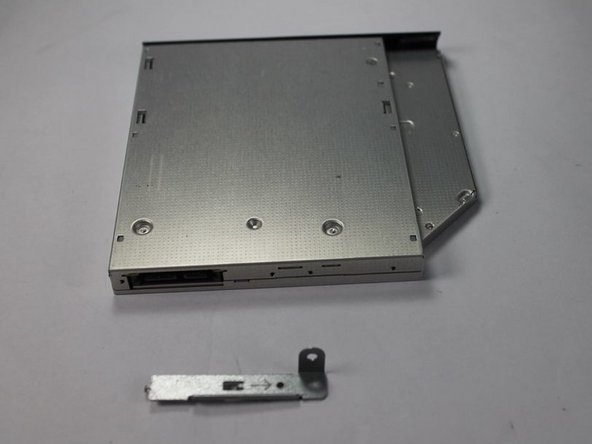

  7. Acer Aspire 4743-6481 DVD Drive Replacement: crwdns2935265:07crwdnd2935265:01crwdnd2935265:02crwdne2935265:0 Acer Aspire 4743-6481 DVD Drive Replacement: crwdns2935265:07crwdnd2935265:02crwdnd2935265:02crwdne2935265:0
    • Face the side of the DVD drive that connects to the laptop and remove the 3mm screw with a Phillips head screwdriver.
    • Put the screw and the bracket to the side as you may need it for your replacement.
