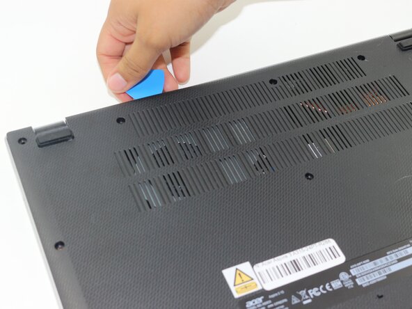

    • For your safety, unplug all peripheries, discharge the battery below 25%, and power down your device before beginning disassembly.
    • Use a Phillips screwdriver to remove the eleven 2 mm screws that secure the lower case.
  2. crwdns2935201:0crwdne2935201:0 crwdns2935203:0crwdne2935203:0
    : crwdns2935265:02crwdnd2935265:01crwdnd2935265:01crwdne2935265:0
    • Insert an opening pick in the seam between the chassis and the lower case.
    • Slide the opening pick around the entire perimeter, prying every couple of centimeters, to release all of the retaining clips that secure the lower case.
    • Remove the lower case.
