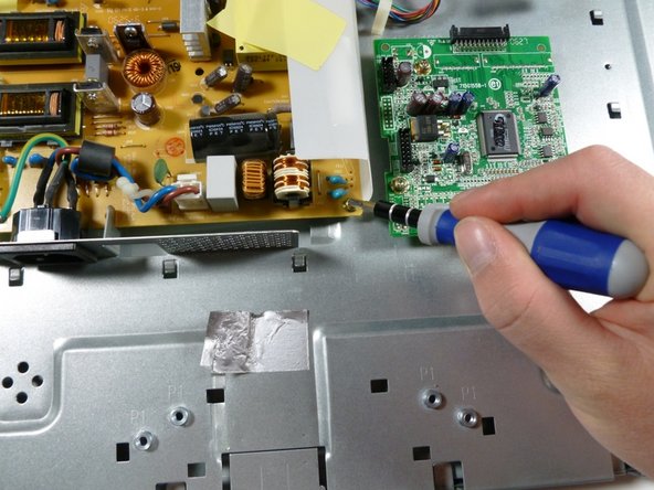

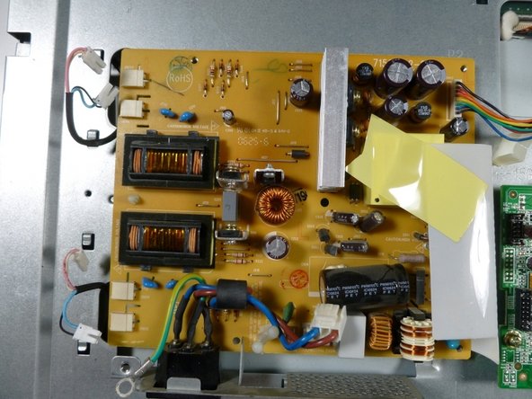

    1. Acer AL1916 Display Replacement, Display: crwdns2935265:010crwdnd2935265:01crwdnd2935265:02crwdne2935265:0 Acer AL1916 Display Replacement, Display: crwdns2935265:010crwdnd2935265:02crwdnd2935265:02crwdne2935265:0
      • Remove the three gold 7.5 mm Phillips #2 screws and one silver 8.3 mm Phillips #2 screw from the power supply.

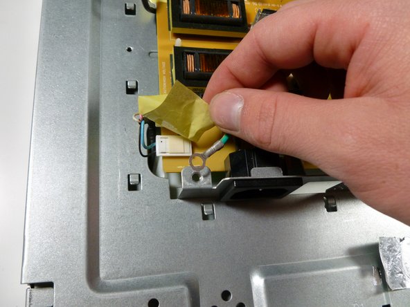

    2. Acer AL1916 Display Replacement: crwdns2935265:011crwdnd2935265:01crwdnd2935265:03crwdne2935265:0 Acer AL1916 Display Replacement: crwdns2935265:011crwdnd2935265:02crwdnd2935265:03crwdne2935265:0 Acer AL1916 Display Replacement: crwdns2935265:011crwdnd2935265:03crwdnd2935265:03crwdne2935265:0
      • Remove the two pieces of yellow tape on the left side of the power supply.

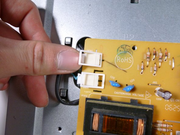

    3. Acer AL1916 Display Replacement: crwdns2935265:012crwdnd2935265:01crwdnd2935265:02crwdne2935265:0 Acer AL1916 Display Replacement: crwdns2935265:012crwdnd2935265:02crwdnd2935265:02crwdne2935265:0
      • Remove the four little white clips located underneath the pieces of tape by lifting up on their left side.

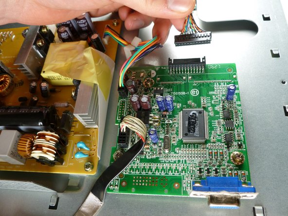

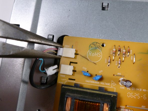

    4. Acer AL1916 Display Replacement: crwdns2935265:013crwdnd2935265:01crwdnd2935265:03crwdne2935265:0 Acer AL1916 Display Replacement: crwdns2935265:013crwdnd2935265:02crwdnd2935265:03crwdne2935265:0 Acer AL1916 Display Replacement: crwdns2935265:013crwdnd2935265:03crwdnd2935265:03crwdne2935265:0
      • With the needle-nose pliers, remove the four display connectors by pulling directly left.

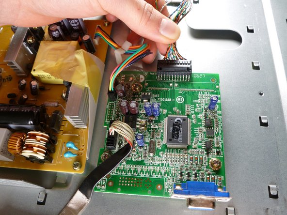

    5. Acer AL1916 Display Replacement: crwdns2935265:014crwdnd2935265:01crwdnd2935265:03crwdne2935265:0 Acer AL1916 Display Replacement: crwdns2935265:014crwdnd2935265:02crwdnd2935265:03crwdne2935265:0 Acer AL1916 Display Replacement: crwdns2935265:014crwdnd2935265:03crwdnd2935265:03crwdne2935265:0
      • Remove the display cable located at the top of the circuit board by pulling it out towards the top of the monitor.

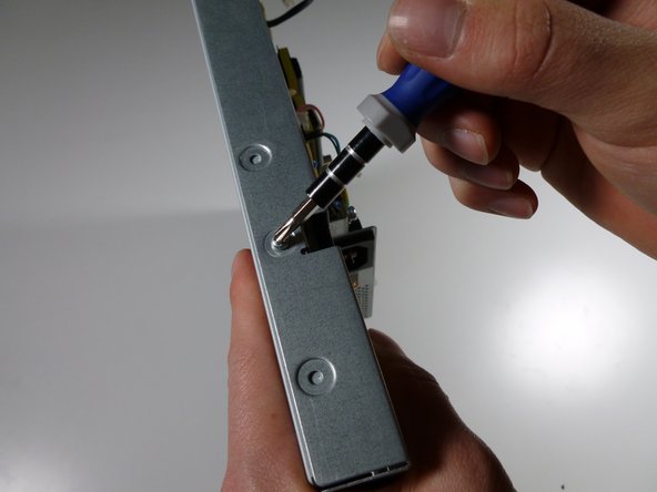

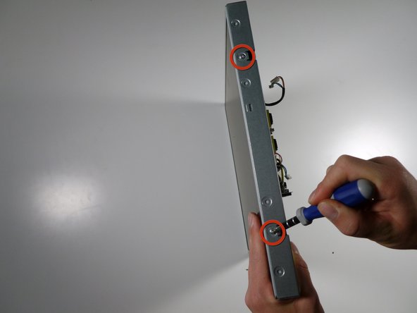

    6. Acer AL1916 Display Replacement: crwdns2935265:015crwdnd2935265:01crwdnd2935265:03crwdne2935265:0 Acer AL1916 Display Replacement: crwdns2935265:015crwdnd2935265:02crwdnd2935265:03crwdne2935265:0 Acer AL1916 Display Replacement: crwdns2935265:015crwdnd2935265:03crwdnd2935265:03crwdne2935265:0
      • Turn the monitor on its side so that the power supply and circuit board are facing to the right
      • Remove the two 6.6 mm Phillips #2 screws located on both sides of the metal casing (four screws total).

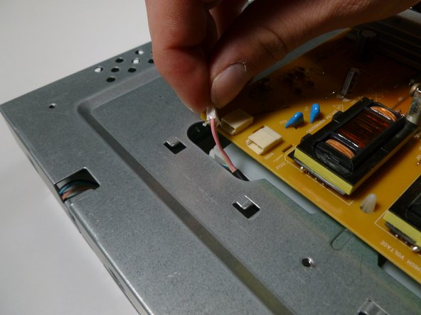

    7. Acer AL1916 Display Replacement: crwdns2935265:016crwdnd2935265:01crwdnd2935265:02crwdne2935265:0 Acer AL1916 Display Replacement: crwdns2935265:016crwdnd2935265:02crwdnd2935265:02crwdne2935265:0
      • Set the monitor back down so that the power supply and circuit board are facing you.
      • Feed all four of the connector wires down through the metal casing.
    8. Acer AL1916 Display Replacement: crwdns2935265:017crwdnd2935265:01crwdnd2935265:03crwdne2935265:0 Acer AL1916 Display Replacement: crwdns2935265:017crwdnd2935265:02crwdnd2935265:03crwdne2935265:0 Acer AL1916 Display Replacement: crwdns2935265:017crwdnd2935265:03crwdnd2935265:03crwdne2935265:0

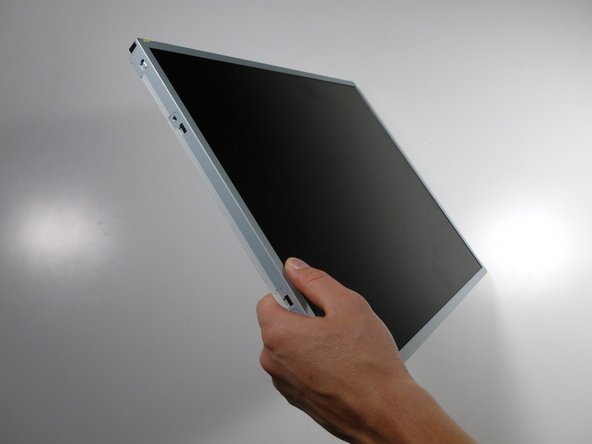

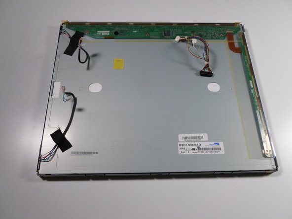

      • Grab the sides of the metal casing and lift up.
      • Turn the display over to see the front; you are ready replace the broken display with a new one!
