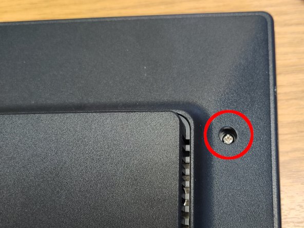

    • Squeeze a little to release the clip that holds the cover in place (top middle) and lift directly away from the monitor.
    • Remove 6 Philips screws and the stand will lift straight off

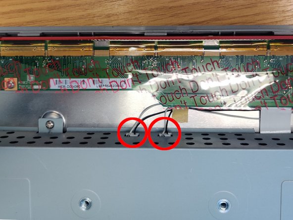

  4. Acer AL1717 PSU Capacitors Replacement, Unplug connectors: crwdns2935265:04crwdnd2935265:01crwdnd2935265:02crwdne2935265:0 Acer AL1717 PSU Capacitors Replacement, Unplug connectors: crwdns2935265:04crwdnd2935265:02crwdnd2935265:02crwdne2935265:0
    • Pull out the two plugs on the side of the inner shielding, they should pull straight out fairly easy. Note blue at top and pink at bottom.
    • Do the same for the two plugs at the top.

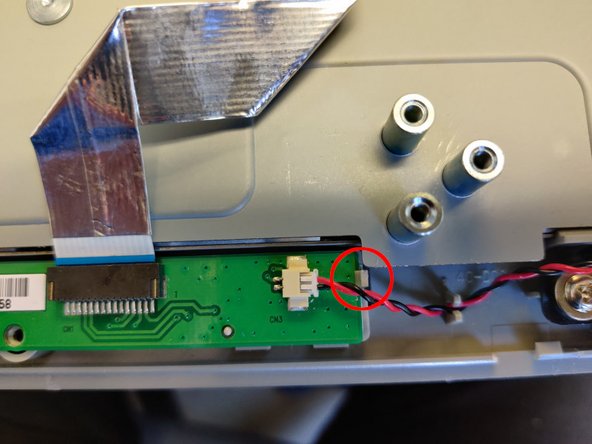

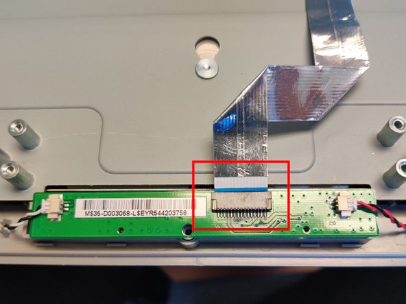

  5. Acer AL1717 PSU Capacitors Replacement, Loosen and unplug ribbon cable: crwdns2935265:05crwdnd2935265:01crwdnd2935265:03crwdne2935265:0 Acer AL1717 PSU Capacitors Replacement, Loosen and unplug ribbon cable: crwdns2935265:05crwdnd2935265:02crwdnd2935265:03crwdne2935265:0 Acer AL1717 PSU Capacitors Replacement, Loosen and unplug ribbon cable: crwdns2935265:05crwdnd2935265:03crwdnd2935265:03crwdne2935265:0
    • Gently peel this ribbon cable off the shielding.
    • These ribbon cables can be fragile so do not excessively bend, stretch, twist etc - it may help to slide a credit card underneath to loosen the adhesive.
    • Pull the plastic retaining clip away from the PCB (gently so it doesn't break) to remove the PCB for better access to the ribbon cable connector. It'll still be attached to the speakers but we are only loosening it.
    • Pull ribbon cable carefully out of its connector.

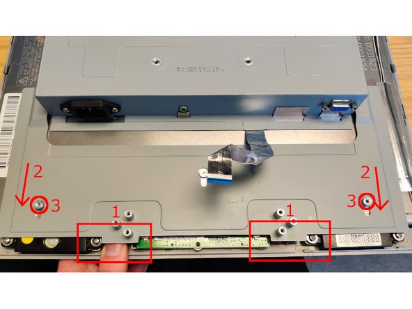

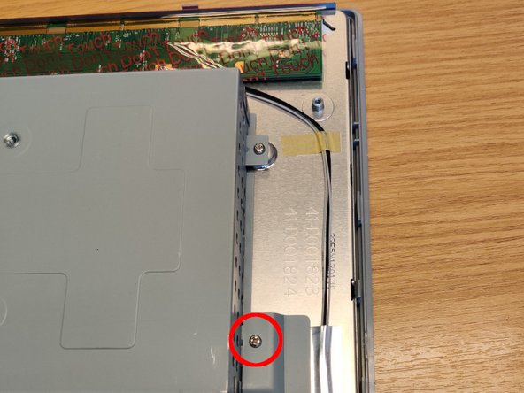

  6. Acer AL1717 PSU Capacitors Replacement, Remove sliding metal plate: crwdns2935265:06crwdnd2935265:01crwdnd2935265:03crwdne2935265:0 Acer AL1717 PSU Capacitors Replacement, Remove sliding metal plate: crwdns2935265:06crwdnd2935265:02crwdnd2935265:03crwdne2935265:0 Acer AL1717 PSU Capacitors Replacement, Remove sliding metal plate: crwdns2935265:06crwdnd2935265:03crwdnd2935265:03crwdne2935265:0
    • Remove 2x Philips screws bottom left and bottom right of inner shielding to release the sliding plate
    • The plastic surround at points marked (1) can be pushed outwards a little (away from and perpendicular to the LCD panel) e.g. with a thumb and forefingers as shown, which gives clearance to the metal plate so it can slide in the direction of the arrows (2) until the slot is aligned as in (3). This plate can then lift off.
  7. Acer AL1717 PSU Capacitors Replacement, Remove 2 screws from shield: crwdns2935265:07crwdnd2935265:01crwdnd2935265:02crwdne2935265:0 Acer AL1717 PSU Capacitors Replacement, Remove 2 screws from shield: crwdns2935265:07crwdnd2935265:02crwdnd2935265:02crwdne2935265:0

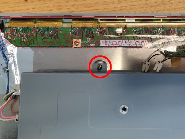

    • Remove 2 remaining Philips screws from top left and top right of inner shield
  8. Acer AL1717 PSU Capacitors Replacement, Remove metal shield: crwdns2935265:08crwdnd2935265:01crwdnd2935265:02crwdne2935265:0 Acer AL1717 PSU Capacitors Replacement, Remove metal shield: crwdns2935265:08crwdnd2935265:02crwdnd2935265:02crwdne2935265:0

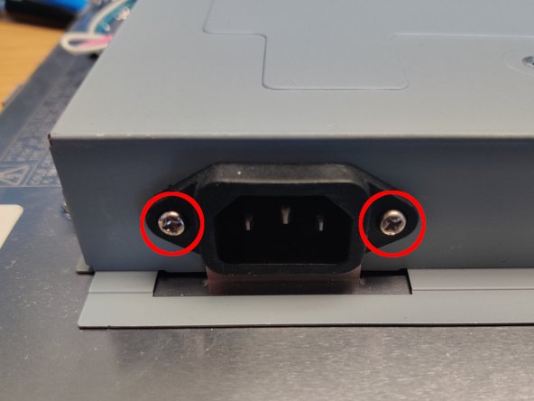

    • Use 5mm hex socket or plyers to undo the VGA retaining hex nuts
    • Remove 2 Philips screws from AC connector
    • Then the inner metal shield/housing can finally be lifted off (directly upwards) to expose the circuitry.

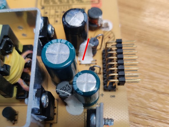

    • Capacitors store a charge, which can shock you. The ones on this board are relatively small and should be harmless, but to be on the safe side leave it unplugged for 24 hours and consider using a capacitor discharge probe or multimeter set to current measurement to discharge them.
    • Remove 3 Short Philips screws and 1 large Philips screw with washer (marked *) to release the PSU board. It pulls upwards a little off the standoffs and directly away from the connector to the logic/i/o board.

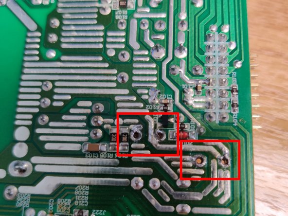

  10. Acer AL1717 PSU Capacitors Replacement, Remove faulty capacitors: crwdns2935265:010crwdnd2935265:01crwdnd2935265:03crwdne2935265:0 Acer AL1717 PSU Capacitors Replacement, Remove faulty capacitors: crwdns2935265:010crwdnd2935265:02crwdnd2935265:03crwdne2935265:0 Acer AL1717 PSU Capacitors Replacement, Remove faulty capacitors: crwdns2935265:010crwdnd2935265:03crwdnd2935265:03crwdne2935265:0
    Desoldering Pump
    $3.99
    • Identify the two capacitors to be changed as circled. Make a mental note of their orientation in case you happen to have a different version of the board, or take a photo. It is likely that they are bulging at the top, and possibly leaking. (Not visible in the first photo as it was taken with the new capacitors in place)
    • Use the pocket knife to slice along the line shown in the second image to free the capacitor from the 'glue' that is sticking it to other components and do the same for the glue on the other capacitor. The image shows one of the bad capacitors removed and the remaining bad one (you can see the bulge here)
    • With the aid of a solder sucker or desoldering braid, desolder the capacitors - their location from the circuit side is highlighted in the third image (which shows both removed). You will need to pull on the capacitor from the component side of the board while heating each leg alternately, 'walking' it out of the board.
    • Ensure the holes are clear of solder so that the replacements will go in.
