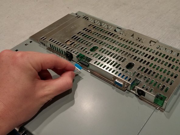

    3. Acer AL1714 Video Display Board: crwdns2935265:03crwdnd2935265:01crwdnd2935265:03crwdne2935265:0 Acer AL1714 Video Display Board: crwdns2935265:03crwdnd2935265:02crwdnd2935265:03crwdne2935265:0 Acer AL1714 Video Display Board: crwdns2935265:03crwdnd2935265:03crwdnd2935265:03crwdne2935265:0

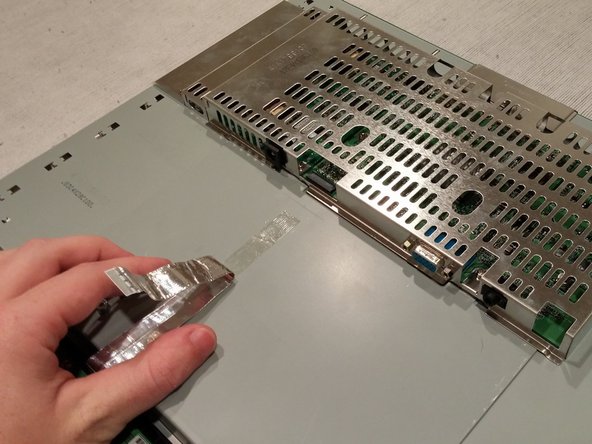

      • Remove the Flat Flex Cable from the Power Supply board located under the metal cage.
      • Pull the cord back and out of the way.
      • (It may be stuck down with adhesive)

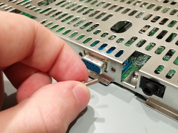

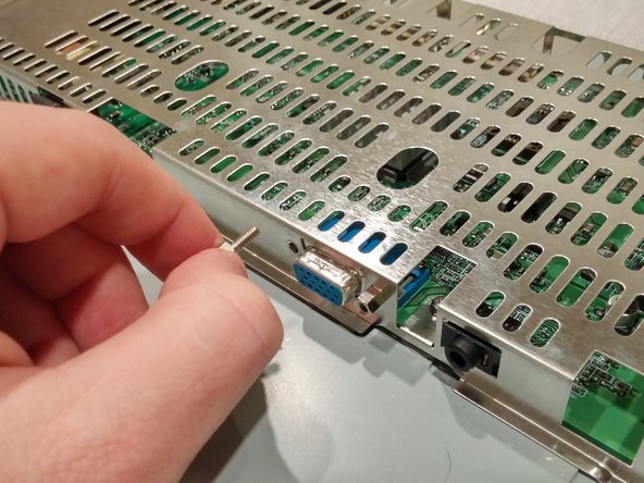

    4. Acer AL1714 Video Display Board: crwdns2935265:04crwdnd2935265:01crwdnd2935265:03crwdne2935265:0 Acer AL1714 Video Display Board: crwdns2935265:04crwdnd2935265:02crwdnd2935265:03crwdne2935265:0 Acer AL1714 Video Display Board: crwdns2935265:04crwdnd2935265:03crwdnd2935265:03crwdne2935265:0
      • Unscrew the cord anchors for the VGA port.
      • (Use needle nose pliers if they're too tight for removal by hand)

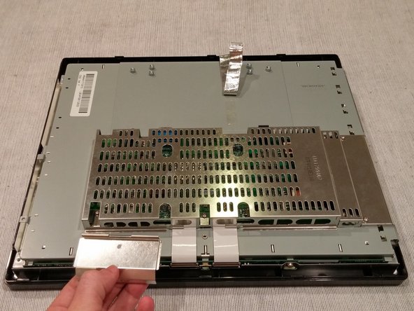

      • Turn the monitor around.
      • Unscrew the 1 screw holding the Flat power Cable cover on.
      • Lift up and remove the Flat Power Cable cover.
      • (Careful: this may be sharp)
    6. Acer AL1714 Video Display Board: crwdns2935265:06crwdnd2935265:01crwdnd2935265:01crwdne2935265:0
      • Unscrew the 5 screws holding the metal cage on.
    7. Acer AL1714 Video Display Board: crwdns2935265:07crwdnd2935265:01crwdnd2935265:02crwdne2935265:0 Acer AL1714 Video Display Board: crwdns2935265:07crwdnd2935265:02crwdnd2935265:02crwdne2935265:0

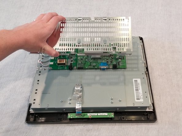

      • Lift the back of the metal cage slightly.
      • Pull the cage toward self.
      • (Must be careful to free the cover of the VGA port and the power supply input)

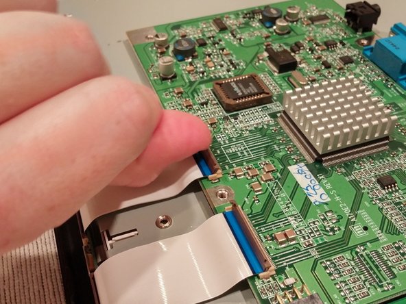

    8. Acer AL1714 Video Display Board: crwdns2935265:08crwdnd2935265:01crwdnd2935265:03crwdne2935265:0 Acer AL1714 Video Display Board: crwdns2935265:08crwdnd2935265:02crwdnd2935265:03crwdne2935265:0 Acer AL1714 Video Display Board: crwdns2935265:08crwdnd2935265:03crwdnd2935265:03crwdne2935265:0

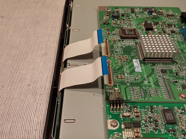

      • Lift the Flat Flex Cable holder tabs to release the cables.
      • Lift up on the Flat Flex Cables and bend them out of the working area.

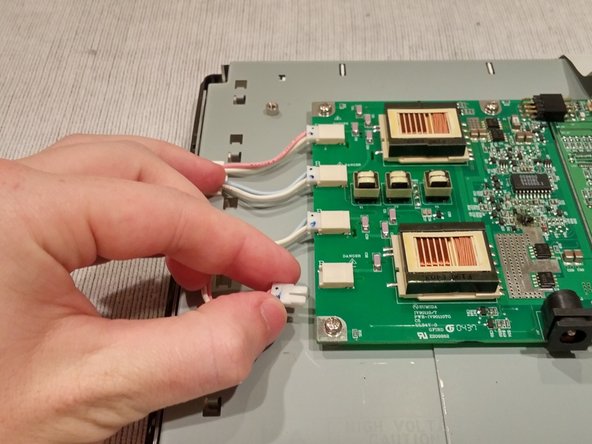

    9. Acer AL1714 Video Display Board: crwdns2935265:09crwdnd2935265:01crwdnd2935265:03crwdne2935265:0 Acer AL1714 Video Display Board: crwdns2935265:09crwdnd2935265:02crwdnd2935265:03crwdne2935265:0 Acer AL1714 Video Display Board: crwdns2935265:09crwdnd2935265:03crwdnd2935265:03crwdne2935265:0

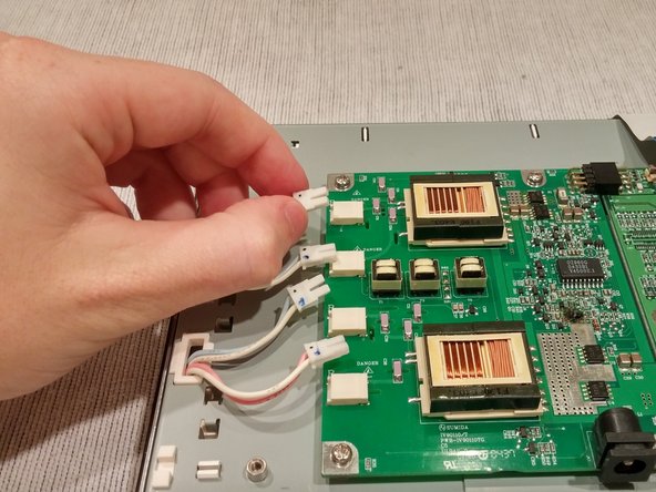

      • Unplug the 4 backlight wires from their ports on the Power Supply Board.
      • (Considering their size, the best way to unplug the backlight wires is by slowly jiggling the wires out of place)

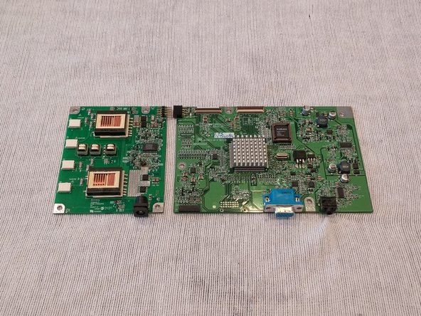

    10. Acer AL1714 Video Display Board: crwdns2935265:010crwdnd2935265:01crwdnd2935265:01crwdne2935265:0
      • Unscrew the 5 screws holding the Power Supply and Video Display boards.

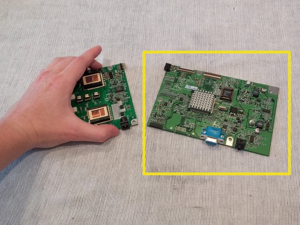

    11. Acer AL1714 Video Display Board: crwdns2935265:011crwdnd2935265:01crwdnd2935265:02crwdne2935265:0 Acer AL1714 Video Display Board: crwdns2935265:011crwdnd2935265:02crwdnd2935265:02crwdne2935265:0

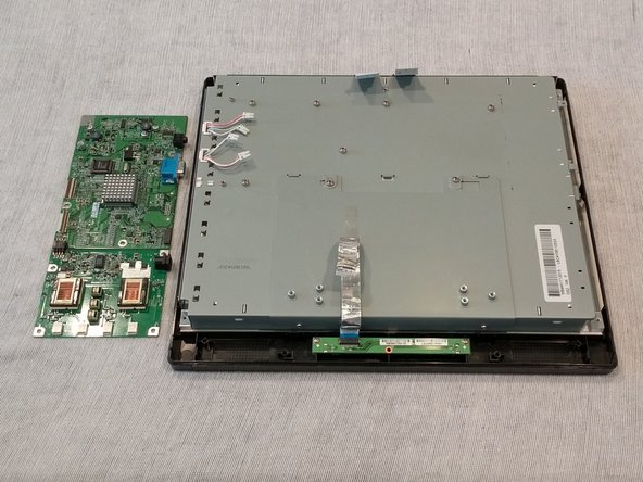

      • Lift and remove the joined boards.
    12. Acer AL1714 Video Display Board: crwdns2935265:012crwdnd2935265:01crwdnd2935265:03crwdne2935265:0 Acer AL1714 Video Display Board: crwdns2935265:012crwdnd2935265:02crwdnd2935265:03crwdne2935265:0 Acer AL1714 Video Display Board: crwdns2935265:012crwdnd2935265:03crwdnd2935265:03crwdne2935265:0
      • Carefully detach the two boards at their connector joint.
      • Replace outlined part.
