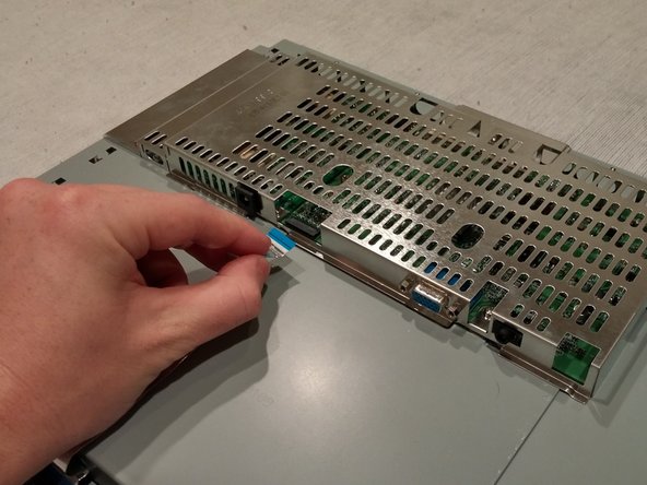

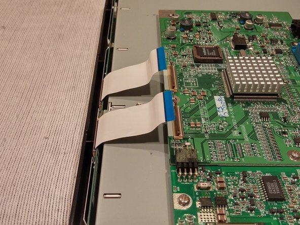

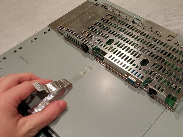

  3. Acer AL1714 Power Supply Board: crwdns2935265:03crwdnd2935265:01crwdnd2935265:03crwdne2935265:0 Acer AL1714 Power Supply Board: crwdns2935265:03crwdnd2935265:02crwdnd2935265:03crwdne2935265:0 Acer AL1714 Power Supply Board: crwdns2935265:03crwdnd2935265:03crwdnd2935265:03crwdne2935265:0
    • Remove the Flat Flex Cable from the Power Supply board under the metal cover.
    • Pull the cord back and out of the way.
    • (It may be stuck down with adhesive)

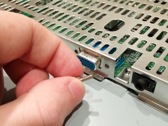

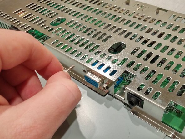

  4. Acer AL1714 Power Supply Board: crwdns2935265:04crwdnd2935265:01crwdnd2935265:03crwdne2935265:0 Acer AL1714 Power Supply Board: crwdns2935265:04crwdnd2935265:02crwdnd2935265:03crwdne2935265:0 Acer AL1714 Power Supply Board: crwdns2935265:04crwdnd2935265:03crwdnd2935265:03crwdne2935265:0
    • Unscrew the cord anchors for the VGA port.
    • (Use needle nose pliers if they're too tight for removal by hand)

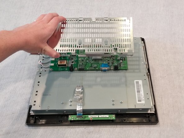

  6. Acer AL1714 Power Supply Board: crwdns2935265:06crwdnd2935265:01crwdnd2935265:01crwdne2935265:0
    • Unscrew the 5 screws holding the metal cage on.
  7. Acer AL1714 Power Supply Board: crwdns2935265:07crwdnd2935265:01crwdnd2935265:02crwdne2935265:0 Acer AL1714 Power Supply Board: crwdns2935265:07crwdnd2935265:02crwdnd2935265:02crwdne2935265:0
    • Turn the monitor around.
    • Lift up on the back of the metal cage slightly.
    • Pull the cage toward self.
    • (Must be careful to free the cover of the VGA port and power supply input)
  8. Acer AL1714 Power Supply Board: crwdns2935265:08crwdnd2935265:01crwdnd2935265:03crwdne2935265:0 Acer AL1714 Power Supply Board: crwdns2935265:08crwdnd2935265:02crwdnd2935265:03crwdne2935265:0 Acer AL1714 Power Supply Board: crwdns2935265:08crwdnd2935265:03crwdnd2935265:03crwdne2935265:0
    • Lift up on the Flat Flex Cable holder tabs to release the cords.
    • Lift up on the Flat Flex Cables and bend them out of the working area.

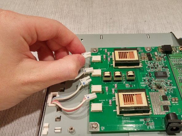

  9. Acer AL1714 Power Supply Board: crwdns2935265:09crwdnd2935265:01crwdnd2935265:03crwdne2935265:0 Acer AL1714 Power Supply Board: crwdns2935265:09crwdnd2935265:02crwdnd2935265:03crwdne2935265:0 Acer AL1714 Power Supply Board: crwdns2935265:09crwdnd2935265:03crwdnd2935265:03crwdne2935265:0
    • Unplug the 4 backlight wires from their ports on the Power Supply Board.
    • (Considering their size, the best way to unplug the backlight wires is by slowly jiggling and pulling the wires out of place)

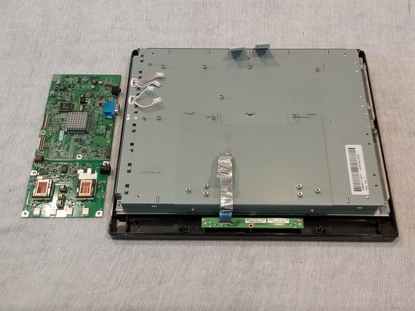

  11. Acer AL1714 Power Supply Board: crwdns2935265:011crwdnd2935265:01crwdnd2935265:02crwdne2935265:0 Acer AL1714 Power Supply Board: crwdns2935265:011crwdnd2935265:02crwdnd2935265:02crwdne2935265:0
    • Lift and remove the joined Power Supply and Video Display boards.

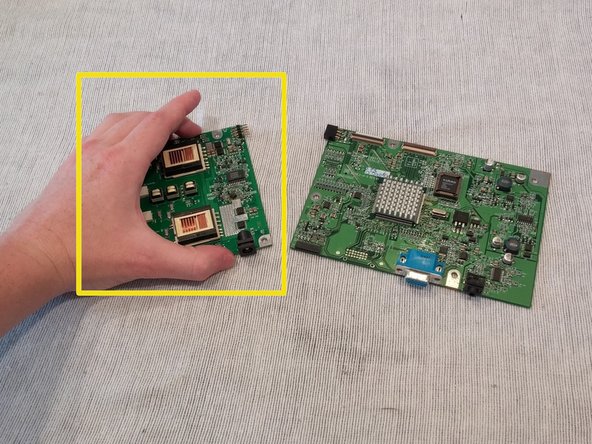

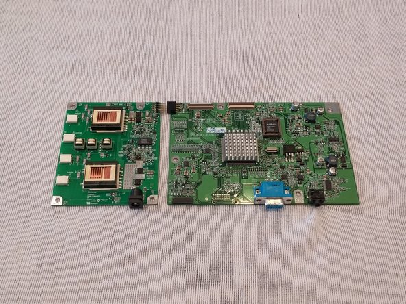

  12. Acer AL1714 Power Supply Board: crwdns2935265:012crwdnd2935265:01crwdnd2935265:03crwdne2935265:0 Acer AL1714 Power Supply Board: crwdns2935265:012crwdnd2935265:02crwdnd2935265:03crwdne2935265:0 Acer AL1714 Power Supply Board: crwdns2935265:012crwdnd2935265:03crwdnd2935265:03crwdne2935265:0
    • Carefully detach the Power Supply and Video Display boards at their connector joint.
    • Replace the Power Supply Board with a new part.
