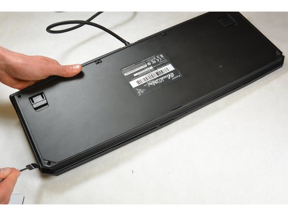

    • There are two tabs on both sides of where the cable enters the back of the keyboard. Use the metal spudgers to gently pull up the tabs. These are circled in red on the picture.
  2. Accessing LEDs and Switches in Razer Blackwidow Ultimate 2013: crwdns2935265:02crwdnd2935265:01crwdnd2935265:03crwdne2935265:0 Accessing LEDs and Switches in Razer Blackwidow Ultimate 2013: crwdns2935265:02crwdnd2935265:02crwdnd2935265:03crwdne2935265:0 Accessing LEDs and Switches in Razer Blackwidow Ultimate 2013: crwdns2935265:02crwdnd2935265:03crwdnd2935265:03crwdne2935265:0
    • Use the plastic opening tool to remove the rubber pads at each corner.
    • Once removed, there are 10mm screws below each pad. Remove the screws using the phillips-head screwdriver.

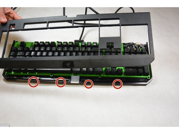

    • Utilizing your broad metal spudger, begin to pry off the faceplate of the keyboard.
    • There are small tabs between the faceplate and the keyboard's base that must be released. There are four tabs along the front of the keyboard and two along each side. Examples of the tabs you are looking for are circled in the third image.

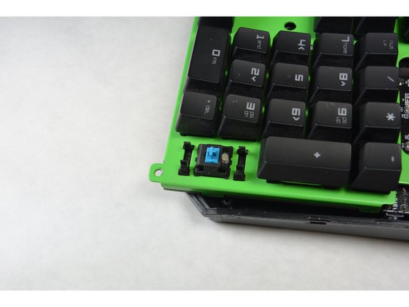

    • Keys can be removed from the board by pulling them upward with your fingers.
    • Larger keys can be removed by lifting the key away to expose the metal pin underneath for added support. Detach the pin by pulling out from the plastic tabs holding the pin using tweezers.
