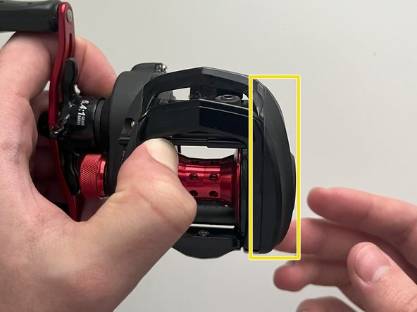

    • Make sure you take off all the line on the reels spool.
  2. Abu Garcia Black Max Spool Replacement: crwdns2935265:02crwdnd2935265:01crwdnd2935265:02crwdne2935265:0 Abu Garcia Black Max Spool Replacement: crwdns2935265:02crwdnd2935265:02crwdnd2935265:02crwdne2935265:0
    • Take the black pin and apply pressure, pushing the pin to the left until it cannot go further.
    • On the right side of the reel, pull the side panel towards you until it pops up toward you.
  3. Abu Garcia Black Max Spool Replacement: crwdns2935265:03crwdnd2935265:01crwdnd2935265:01crwdne2935265:0
    • Make sure you are still holding the pin to the left.
    • Slowly pull the side panel to the right until it comes off completely.
  4. Abu Garcia Black Max Spool Replacement: crwdns2935265:04crwdnd2935265:01crwdnd2935265:01crwdne2935265:0
    • Grab the spool with your fingers, and gently pull out the spool from the reel.
    • Grab your replacement spool and have it ready for the next step.
  5. Abu Garcia Black Max Spool Replacement: crwdns2935265:05crwdnd2935265:01crwdnd2935265:01crwdne2935265:0
    • Take your replacement spool and put the spool back inside the reel, the same way you pulled out the old spool.
  6. Abu Garcia Black Max Spool Replacement: crwdns2935265:06crwdnd2935265:01crwdnd2935265:01crwdne2935265:0
    • Make sure that there are no spaces in the left and right sides of the spool once the new spool is in.
  7. Abu Garcia Black Max Spool Replacement: crwdns2935265:07crwdnd2935265:01crwdnd2935265:02crwdne2935265:0 Abu Garcia Black Max Spool Replacement: crwdns2935265:07crwdnd2935265:02crwdnd2935265:02crwdne2935265:0
    • Pull the pin to the left again.
    • Place the black side panel back onto the reel.
    • Once the black side panel is back on, apply downward pressure, pushing the black side panel back, until it clicks into place.
  8. Abu Garcia Black Max Spool Replacement: crwdns2935265:08crwdnd2935265:01crwdnd2935265:01crwdne2935265:0
    • You have now done a complete spool replacement on the Abu Garcia Black Max baitcasting reel.
    • When you decide, you can now put the line back onto the spool.
