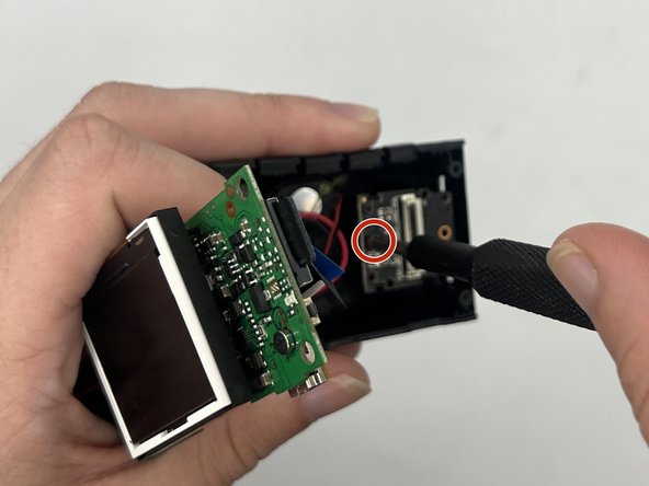

  6. Abask J05 Camera Lens Replacement, Camera: crwdns2935265:06crwdnd2935265:01crwdnd2935265:02crwdne2935265:0 Abask J05 Camera Lens Replacement, Camera: crwdns2935265:06crwdnd2935265:02crwdnd2935265:02crwdne2935265:0
    • Remove the two 7 mm screws on the side of the motherboard with a Phillips #00 screwdriver.
    • Slowly pull up on each corner of the motherboard, stopping when the corner pops loose of the anchor.
    • Repeat the process with each corner before slowly pulling up on the board to detach the glue on the underside.
  7. Abask J05 Camera Lens Replacement: crwdns2935265:07crwdnd2935265:01crwdnd2935265:03crwdne2935265:0 Abask J05 Camera Lens Replacement: crwdns2935265:07crwdnd2935265:02crwdnd2935265:03crwdne2935265:0 Abask J05 Camera Lens Replacement: crwdns2935265:07crwdnd2935265:03crwdnd2935265:03crwdne2935265:0
    • Move the motherboard aside, and peel off the tape over the small black plastic piece.
